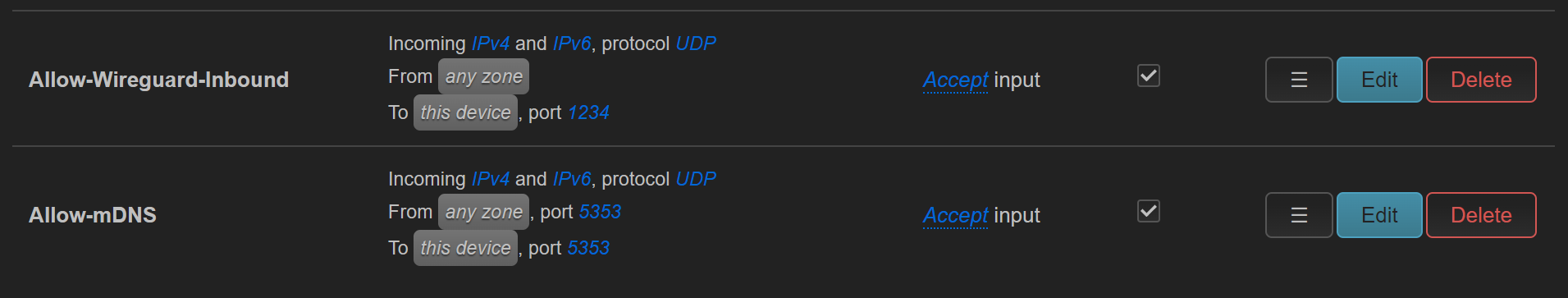

I have the default firewall rules for the omnia plus I added the following two when I setup wireguard, if this helps. maybe the firewall rule for mdns is not correct?
Maybe thumb to ask - but does any zone include WAN? Would be cautious about these generalisation…
Firewall configuration [Old OpenWrt Wiki] or [OpenWrt Wiki] Firewall configuration /etc/config/firewall - I would understand that WAN is one of the two, that are the basis of every config
