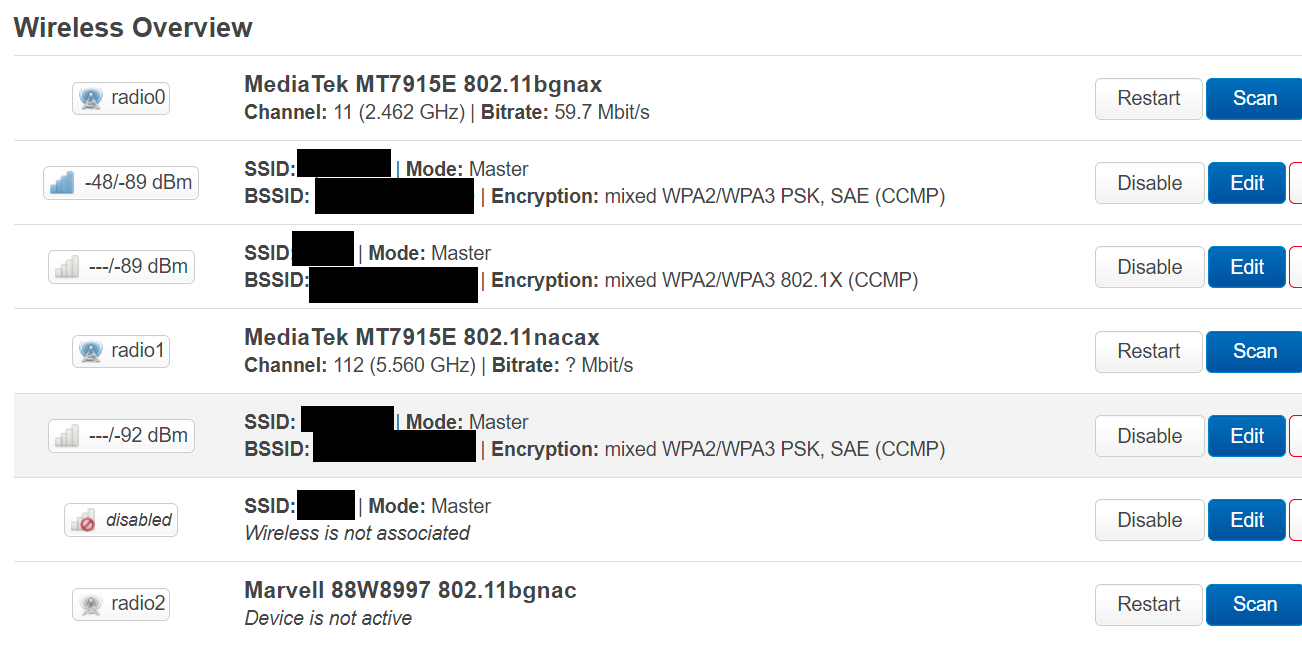

Hi I have upgraded my turris MOX to an AsiaRF AW7915-NPD DBDC and TOS 6.0.3, it seems there are some gremlins inside, I am able to setup only 3 SSIDs, 2 on the 2.4Ghz and 1 on the 5Ghz:
For some unknown reason it seems that I am unable to exceed the amount of SSIDs, did someone encounter a similar issue / know of a WA?
Could you post the output of iw list similar to Single Wifi card, both AP and STA? - #4 by gstrauss ? Maybe we could see some limitations of the card from it.
Sure this is the output of the iw list:

I replaced the original Compex radio modules with two AW7915-NPD modules from 524wifi in my Turris Omnia and they seem to run fine. These are two 2T2R DBDC modules so I’m able to set up two 2.4 GHz and two 5 GHz networks, for a total of four wireless networks, using only 4 antennas with no external diplexers.
On the 7915 modules with Debian kernel 6.0.10 the 5 GHz network is about half as fast as on kernel 6.1-rc6. So there is some patch in the mt76 driver that was merged for 6.1 that you need, otherwise the 7915 on the 5 GHz band is slower than the Compex WLE900VX (for me ~200 Mbps or less in 802.11ax mode vs. ~400 Mbps on the WLE900VX in 802.11ac mode). The throughput/range using 802.11ax mode on the 2.4 GHz band is much improved versus the original Compex WLE200N2 module.
Then, I replaced one of the AW7915-NPD modules with an AW7916-NPD module from AsiaRF and moved my hostapd configs for the previous AW7915-NPD module over to the 7916. The 7916 is supposed to be a tri-band dual band concurrent card that can run 2.4 GHz and either 5 GHz or 6 GHz at the same time. I can run a 2.4 GHz network on the 7916 just fine, but it won’t run a 5 GHz network at all. I did not try to get 6 GHz working on the 7916 since I don’t have an example of a working hostapd.conf and all the 6 GHz channels are showing as “no IR” for some reason.
On the 7916 hostapd starts up just fine but I can’t see the 5 GHz network at all (tried 3 different client devices sitting right next to the Omnia; one Android, one ChromeOS, one Debian). No diplexers, just three pigtails and three Taoglas GW.59.3153 2.4/5.8/7.1 GHz antennas connected directly to the card. And the 7916 card works for the 2.4 GHz network so I’m pretty sure I didn’t mess up the RF and antenna connections.
My Turris Omnia is running Debian bullseye with:
  • linux-image-6.1.0-0-armmp (6.1~rc6-1~exp1) from experimental.
  • Mediatek 7915/7916 firmware from linux-firmware.git (commit cdf9499cf6706b73935a139bb5e76777a87674fe)
  • wireless-regdb (2022.06.06-1) from unstable
  • hostapd compiled from source (commit 8de288142638f1d56ef9278057cdb5263945c163) with CONFIG_IEEE80211AX=y
So my conclusion is the AW7915-NPD is usable if your kernel/firmware/hostapd are very up-to-date, but I’m not sure how to get the AW7916-NPD working. I see the 7916 listed on FAQ - Turris Documentation though, so I’m curious how the Turris team got this card working.
The only thing weird about my Turris Omnia hardware-wise is that it’s an original Indiegogo model with a Kingston SMS200S3120G mSATA SSD installed in the rightmost mini PCIE slot.
Here are the kernel messages when loading the driver:
mt7915e 0000:02:00.0: firmware: direct-loading firmware mediatek/mt7916_rom_patch.bin
mt7915e 0000:02:00.0: HW/SW Version: 0x8a108a10, Build Time: 20221031154652a
mt7915e 0000:02:00.0: firmware: direct-loading firmware mediatek/mt7916_wm.bin
mt7915e 0000:02:00.0: WM Firmware Version: ____000000, Build Time: 20221031154713
mt7915e 0000:02:00.0: firmware: direct-loading firmware mediatek/mt7916_wa.bin
mt7915e 0000:02:00.0: WA Firmware Version: DEV_000000, Build Time: 20221031154757
mt7915e 0000:03:00.0: firmware: direct-loading firmware mediatek/mt7915_rom_patch.bin
mt7915e 0000:03:00.0: HW/SW Version: 0x8a108a10, Build Time: 20220929104113a
mt7915e 0000:03:00.0: firmware: direct-loading firmware mediatek/mt7915_wm.bin
mt7915e 0000:03:00.0: WM Firmware Version: ____000000, Build Time: 20220929104145
mt7915e 0000:03:00.0: firmware: direct-loading firmware mediatek/mt7915_wa.bin
mt7915e 0000:03:00.0: WA Firmware Version: DEV_000000, Build Time: 20220929104205
Here’s the hostapd.conf for the 5 GHz network. Works on the 7915, doesn’t work on the 7916:

Looks like my kernel is missing this patch:
https://patchwork.kernel.org/project/linux-wireless/patch/20220930151315.19012-2-shayne.chen@mediatek.com/
Not sure if not having this patch is the cause of my problem with the 7916 card, though.
Thanks a lot for sharing this information here. I wonder if mentioned latest kernel patch for mt7915 could be backported by team into current 5.15.78 kernel ? For mt7916 further development probably has to be made in future to make it working.
We already have this patch since Turris OS 6.0.0. :wink:
OK, I pulled out the mSATA card with my Debian installation on it and flashed the latest medkit onto the eMMC and installed TurrisOS 6. Then I updated to hbk and installed the kmod-mt7916-firmware package. Also I ran nor-update to flash the boot loader.
This works great now, the 5 GHz band on the 7916 card is working and I can get around 600-700 Mbps with 160 MHz channel width. Also, the 7915 card seems to be faster as well (400-500 Mbps).
I don’t see any way to use the 6e channels, though. They are showing up as “no IR” in iw phy and there are some weird diagnostics logged by foris-controller when I open the Wi-Fi settings in the web interface.
