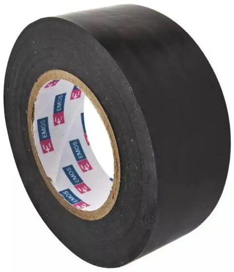

I have drilled a new hole in the NAS box and it works perfectly. By the way does anybody know if it is possible to get the black hole covers after antenas are moved? The link in the guide points to eshop where the say that are out of stock
Maybe write to support so they send you a project and 3d print it yourself

What about electrician black tape?
