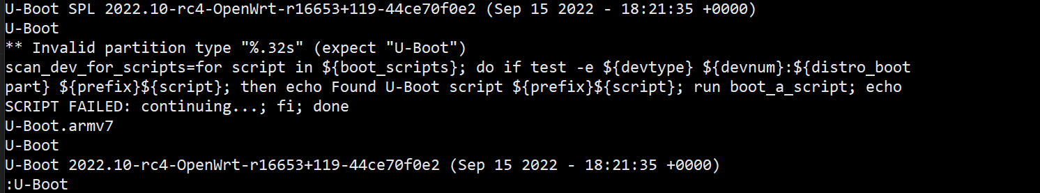

and now U-Boot 2022.10-rc4-OpenWrt-r16653+119-44ce70f0e2 (Sep 15 2022 - 18:21:35 +0000)

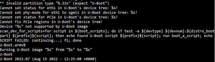

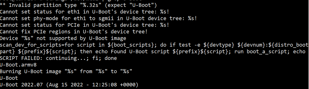

On my MOX (classic, HBK branch, .5 GB, 2x WiFi, simple config) I tried to update firmware etc using reForis. Unfortunately without success, but, with luck, MOX is working :wink:
Current status: OS 6.5.0, HBK, U-boot 2022.07, factory 6.3.2
TurrisOS 6.5.0, Turris Mox
Thu Jan 25 10:12:29 CET 2024
SN: 56639897919
turris-version: 6.5.0
branch: hbk
root@MOXjp:~# strings /dev/mtdblock1 | grep “U-Boot 20”
U-Boot 2022.07 (Aug 15 2022 - 12:25:08 +0000)
root@MOXjp:~# schnapps factory-version
6.3.2
On reForis → Package Management → Packages I checked “Latest firmware”, and both “U-boot and rescue image” & “Factory image”.
Later I run pkgupdate via CLI, while logging it into file. It ended with error(s), neither firmware, nor factory image were changed.
