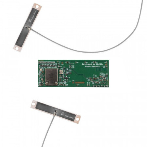

Next limitation is possibility to create only three (not four) SSID with SDIO wi-fi card in MOX A. Or has it already been fixed?
That’s fixed in HBL and HBD branches. It is going to be part of Turris OS 6.0. More details are in the commit message:
Thank you! It might be a good idea to update the documentation, even temporarily.
At the same time, I recommend mentioning SDIO limitations in hardware distribution, but I’ve said that before. After all, the card is not cheap and many people then would prefer mPCIe.
