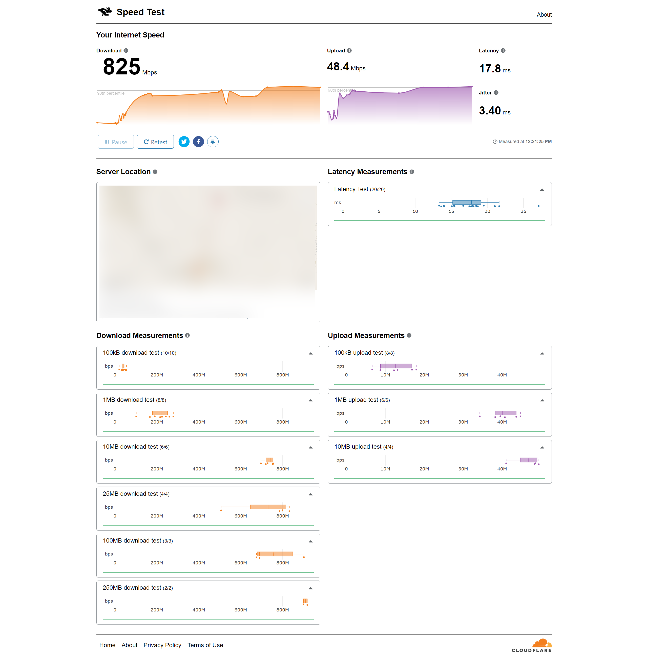

i have a Gigabit connection and want to fully utilize it. I did notice strange behaivior with the Omnia. The throughput is waving, it fluctuates between gigabit and 500 mbit/s. I tested with a factory reset (3.x.x) a updated 3.x.x and with the HBK branch, they show all the same behaivior. If i plug my PC directly in the modem i get stable 940 mbit/s out of it.
Here some screenshots to visualize (take a look at the blue line of the download)
directly connected to the modem
with the omnia in place
Is this “normal” because of hardware limitations or can i do something to fix it?
If you need more informations just write what you need and i will add it.
Thanks for help

other bandwidth suits yielding the same jittery graph, e.g.https://speed.cloudflare.com?
yes there is a second wan connection, but that is only used if the main one dies complete and it is reproducable with the omnia even with the factory image and everything at default.

I have 4.0.5 and htop is about 30-50% on both cores during test. Somethimes foris notify comes up too, but that also without running test. Here is my speed graph:
is a bit more flat and the ditch is actually when he is switching packages size and only happens in Firefox, in Chrome it is like that:
It may helps you if you have compare values. With 3.x.x btw. i never realized a “waving” speedtest.net had everytime a flat graph.
PS: at speedtest.net is the load 90% on one core and 40% on second…but still fast
