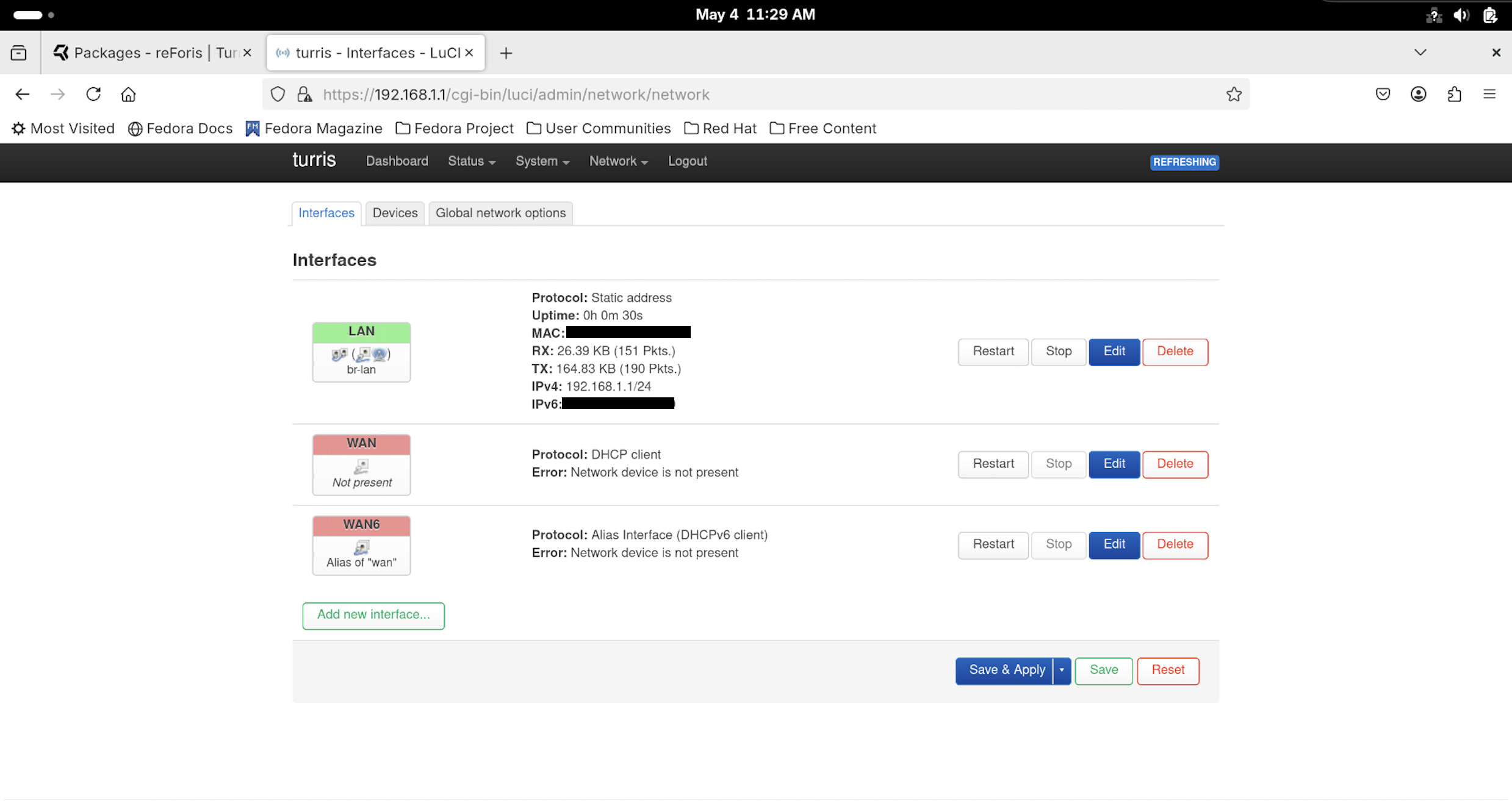

I’m connected to the mox over wifi, nothing is plugged in to the ethernet port, but it won’t allow me to set the ethernet as WAN in the interfaces tab. It’s currently set as LAN. The Save button is greyed out.
Do I need to go into LuCI to make this work?
The problem is that you only have one ethernet port. The second you would press save (for attaching eht1 from lan to wan) the MOX wouldn’t be accessible anymore. I believe that is the reason you cannot save via Foris.
Doing it via luci wouldn’t help either, because luci checks that the connection laptop-MOX is still working and would revert the changes if it is not.

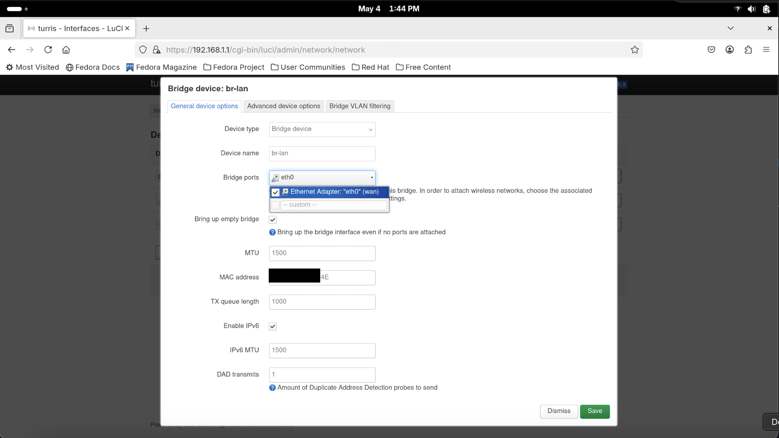

Go to Devices tab and click Configure br-lan there you would have Bridge ports so there should be as you can see in (parenthesis) your eth port and wifi networks. Wifi might be not there actually it might be selected in Wireless section. Nvm.
So deselect your ethernet port so its not part of br-lan. And then go back to interfaces tab and edit your WAN interface and there you put your only ethernet port. Just be sure you are actually connected via WiFi before doing so. And each time save only. And post a screen from Interfaces tab
Actually one more thing would be needed. In Devices tab. Click on Configure for br-lan and make sure Bring up empty bridge is checked. Because when there are only wireless interfaces in the bridge when nothing is connected then wireless interface is down and so the br-lan. And you want that up all time.

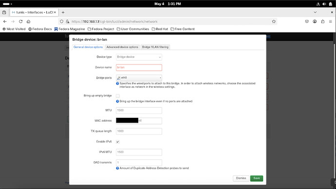

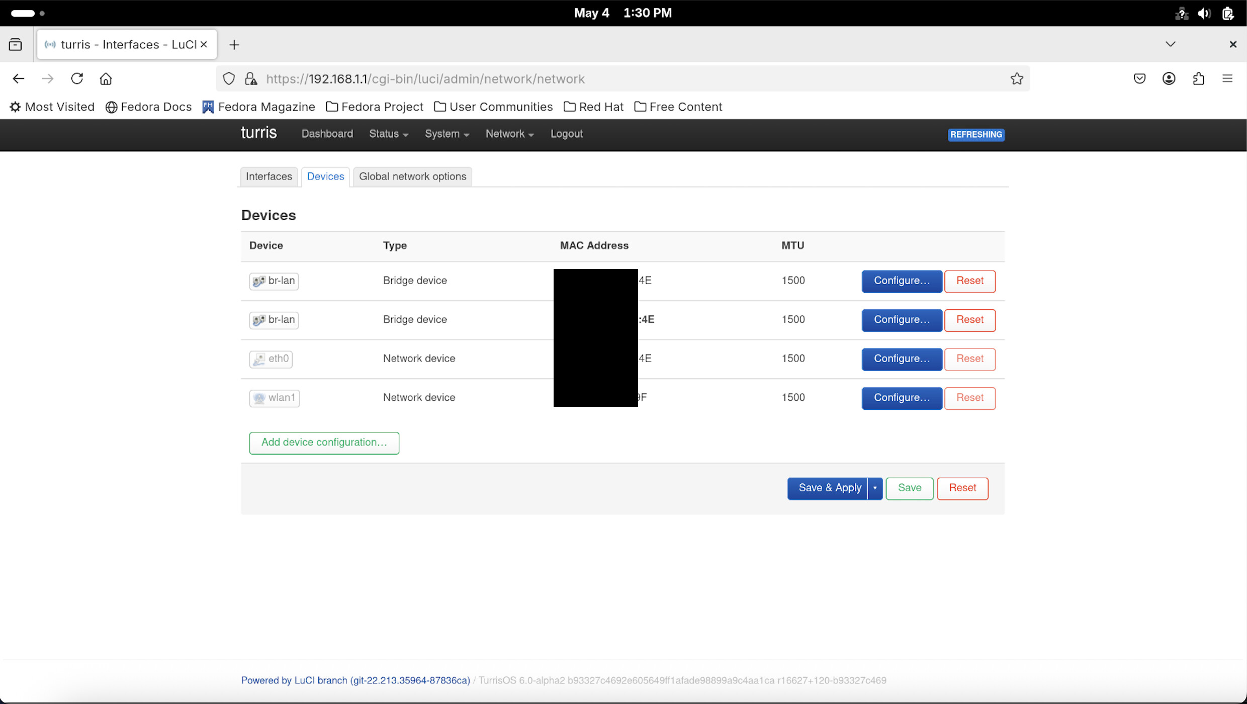

br-lan shows up twice. Which one do I edit, the first or the second?

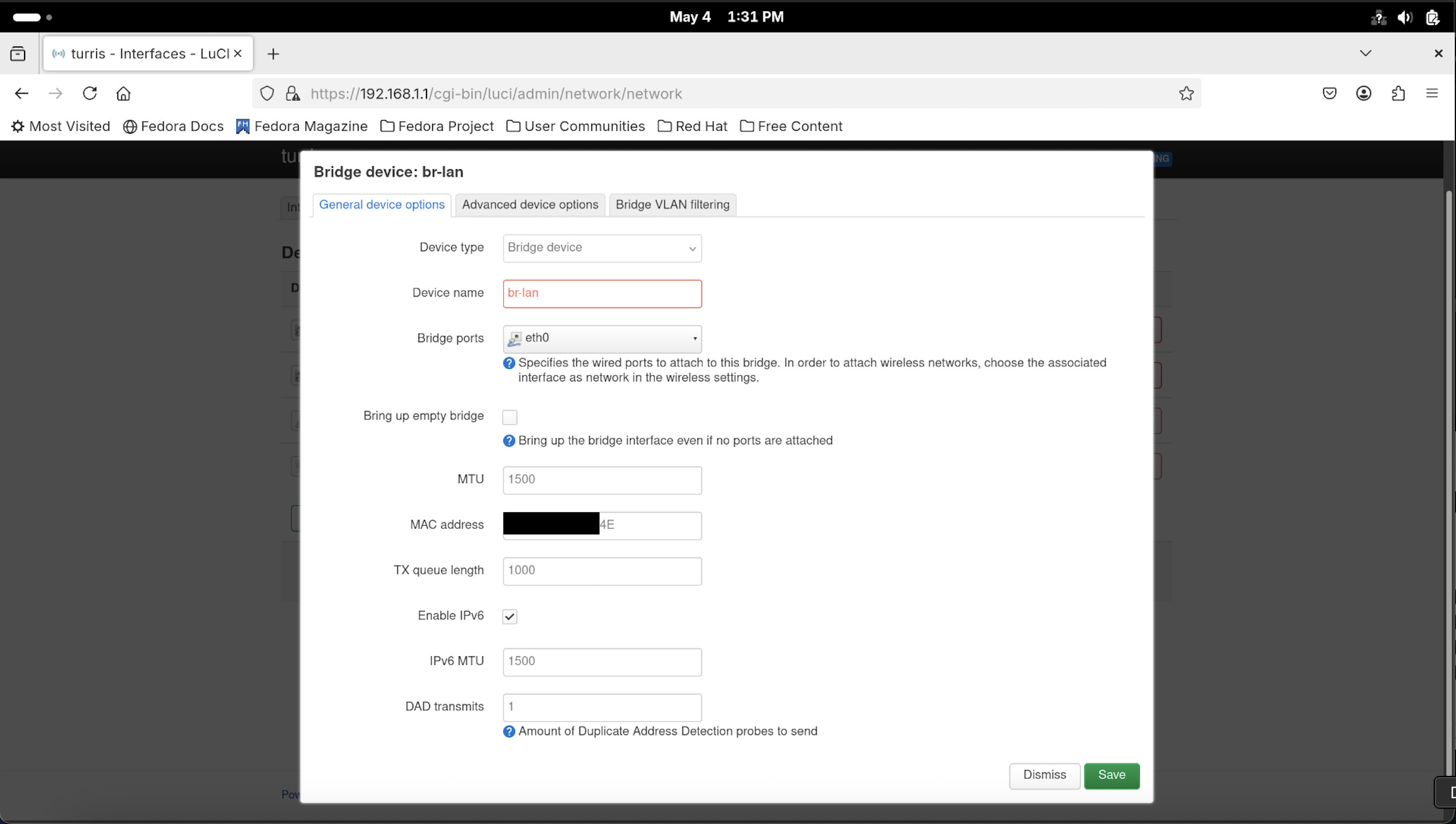

Also, if I try to edit either one, it won’t let me save and the Device name is in red:
Shouldn’t be duplicated in general. I guess its because of it using the same name. Why is it like this not sure. Ok click on Reset for ONE of the br-lan it should disappear. And do stuff I wrote before.

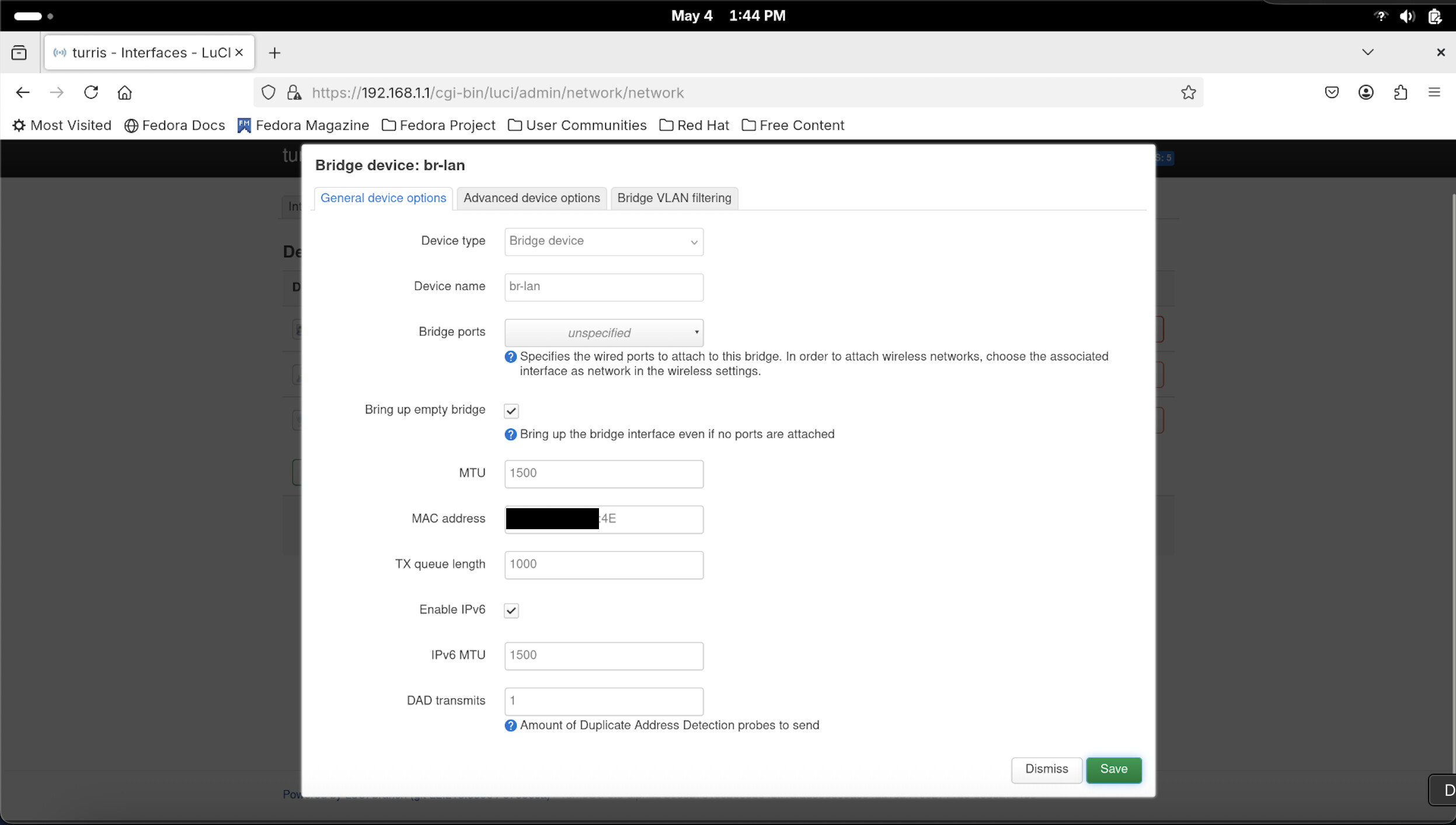

If I deselect my ethernet port in devices ⇒ br-lan ⇒ configure and click Save, it automatically re-adds it.
