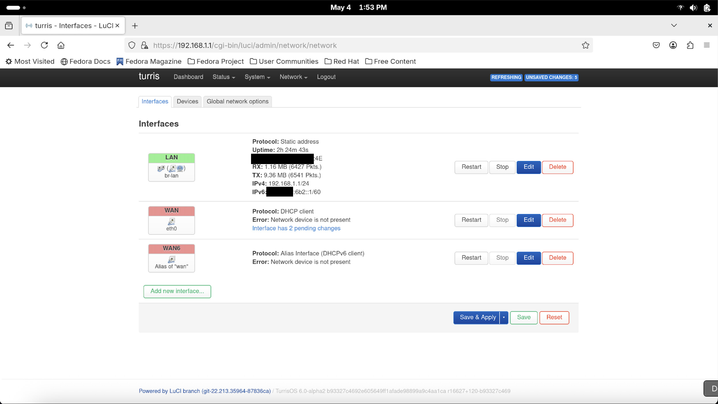

What do you mean by that? Where do you see it? Second screenshot is ok now use eth0 as your WAN interface. Owww you did it already I see from the first screenshot. So now let me look at Network → Interfaces

Hmmmm. I guess it might be Reforis doing it. Go to 192.168.1.1/reforis and make sure eth0 is unassigned
Ok I just clicked “Save and Apply” and that fixed it. Bridge ports now shows “unspecified”
Weird. Almost ok. But eth0 should be not part of br-lan. Or maybe add your wifi interface manually to br-lan so something is there and then remove eth0. Wifi interface should be called wifi0 I guess.
So that should be it. Do you see IP address on WAN? Is cable connected? Is your ISP using DHCP?

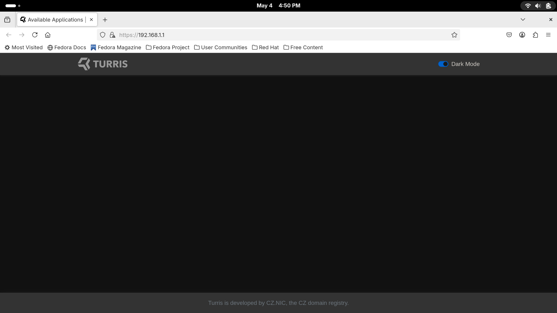

Ok so I did the factory reset and set up wifi, and then I rebooted the mox, and now when I connect to it over wifi it just shows me this (the GUI isn’t usable)
Refresh page. Do you still have static IP on laptop’s wireless interface?
Yes still static IP. I refreshed and it said unable to connect again.
I reconnected over ethernet and now it works. But I need to be able to connect over wifi first before I can set the ethernet port to WAN
ok I unset static IP and now I can connect over wifi
