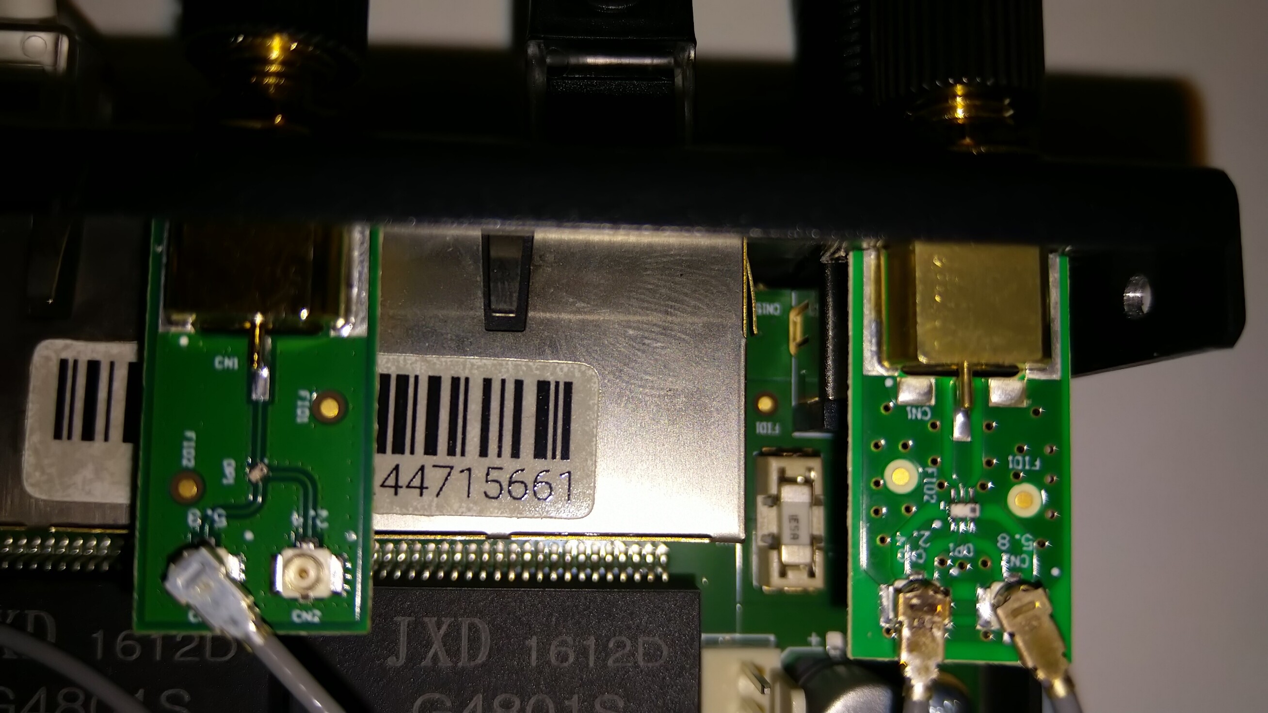

Do you see what i see?
On right is original diplexer, on left is new diplexer for turris from eshop.
Then another update of current installation
Yes exactly, this is what I needed to see.
What we have to see? Diplexers are little bit different, but the numbers at connectors are still there (2.4 , 5.8) :wink:
yeahh but they are opposite, then on original diplexers.
Ok, but there are still those numbers, so no problem.
yes correct, but its from eshop, where image looks like original diplexer, is labeled as " Turris Omnia diplexer", but anyway delivered is evidently different diplexer, where pigtails are vice versa.
I know it works, but looks strange.
Maybe it is just “updated” version and all new Omnias have the same diplexers. I haven´t checked mine new diplexers, which I bought for these new AX cards, but I think they will be the same as yours.
The only place where it is possible to buy these diplexers is Discomp and few CZ and SK e-shops which have them from the same manufacturer (my opinion). So, there is no “fake” diplexer, I think.
Yes, it works, i dont have a problem with that at all, is just confusing. Anyway, i did send an email to discomp, if it is like that and if there is a some reason to have it differently (i have no idea, why i would create opposite design of diplexer, at least from cost point of view it has no sense to change something that works properly). I can imagine, what you told, original diplexers delivered different vendor, then current diplexers are created by another company, even if sold under one label from same shop.
I think, they made som optimisation, and this new is cheaper, or it has to be changed due the lack of semiconductors etc.
