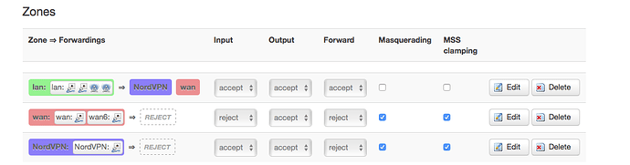

This has been sent to me and seems awesome
https://support.nordvpn.com/hc/en-us/articles/115000254305-OpenWRT-router-tutorial
