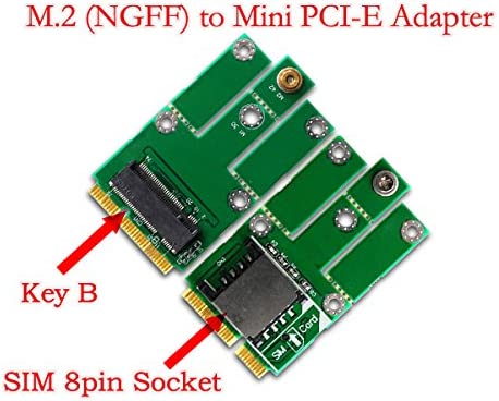

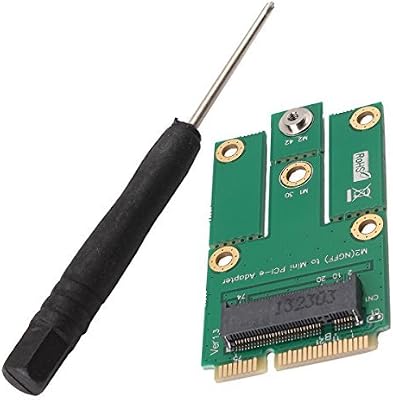

This adapter could be work ?
I have two M.2 SSD (the OCZ&Toshiba RC100, for example) that I would like to use it but probably I can’t because the RC100 is BM and NGFF es A :frowning:
What I see on the listing is:
Support M.2 Key B Card Type.
I think most SATA based M.2 SSDs have B+M keying meaning they can go into both B or M. NVMe will be M only as they usually require four PCI lanes. What is the worse part is that it only really supports shorter PCBs, specifically 2230 and 2242, meaning you can only have 30mm or 42mm SSD. Those are slightly harder to come by. An example could be this KingSpec SSD. If you have a full length SSD (2280 if I’m not mistaken), then you’ll have to figure out a different way to tighten it down as it’s a really bad idea to leave it not secured.

Where did you find support Key B Card Type?
You can see it on the Amazon listing in the Product description section.
I’m still not convinced that this will 100% work with MOX, but it should in theory.
Thank you @fortunerayzor but it is not available in Spain :frowning:
This one is key B compatible but probably to use with cellular or GPS M.2 card :frowning:
I’ll try it … when my MOX works :frowning:
Dear @Pharizna,
I wonder if you had any success with these adapters?
It’s a pity but it is not possibly to use an M.2 internally in the MOX
