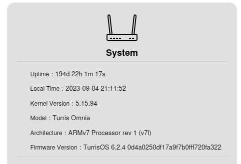

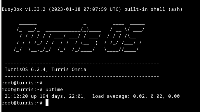

I didn’t have time to apply recent updates, meanwhile sharing my uptime to show how hell stable is this Turris Omnia 2020.
Setup: 2 wifi, 1TB SSD, Samba, MiniDlna, Wireguard, AdBlock, NetData, many devices connected.
uptime_2023-09-04_21-12-46
uptime_2023-09-04_21-12-00
Wonderful.!
