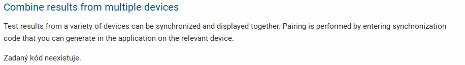

You can please pass this to Netmetr team: from version 3.9.4 RC, on Web page Netmetr does not accept the sync code in the My Measurements option. Also the error message is Czech.
