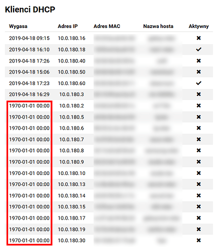

commar
April 18, 2019, 6:35am
13
I confirm. I have the same issue (1970-01-01).
And small issue in PAKON, page 0.

ivanek
April 18, 2019, 9:17am
14
I do have the same issue with DHCP lease time set to 1970-01-01 00:00
. This seems to be the case only for clients with fixed IP address which are currently not connected to the network.
the DHCP date issue (disconnected clients with fixed ip) seems to be a sole Foris bug which also happens with odhcp
instead of dnsmasq

@Radovan_Haban : Can you please provide us more details about the crash in the Region and Time tab in Foris? Do you have an error message from that? It would be great if you can send it to tech.support@turris.cz so we can look at it.
About the DHCP expiration lease time, it’s a good catch. Thank you for reporting. We have been able to reproduce it. It is just a cosmetic issue and it isn’t related to anything that @n8v8r said. It doesn’t affect anything. Right now, the Foris read the value 0 and interpret it as 1970-01-01 00:00. In the next release, it will show N/A.
