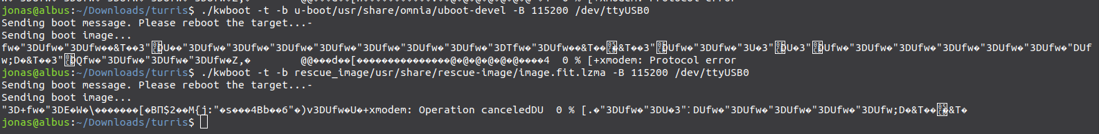

  • Booting the turris over serial cable, based on 2. sendbeacon returns 0 after I connect the power. The kwboot asks immediately for a reboot. After the reboot everything is like before (blinking leds), the command never exit.

Serial Boot:
turris

Because I didn’t know anything else I just tried random stuff. Then I noticed something. When I install an M-Sata SSD the kwboot command suddenly gives an output! Both for the uboot and for the resuce-image. What could that mean?
Unfortunately, I do not understand what that means.
