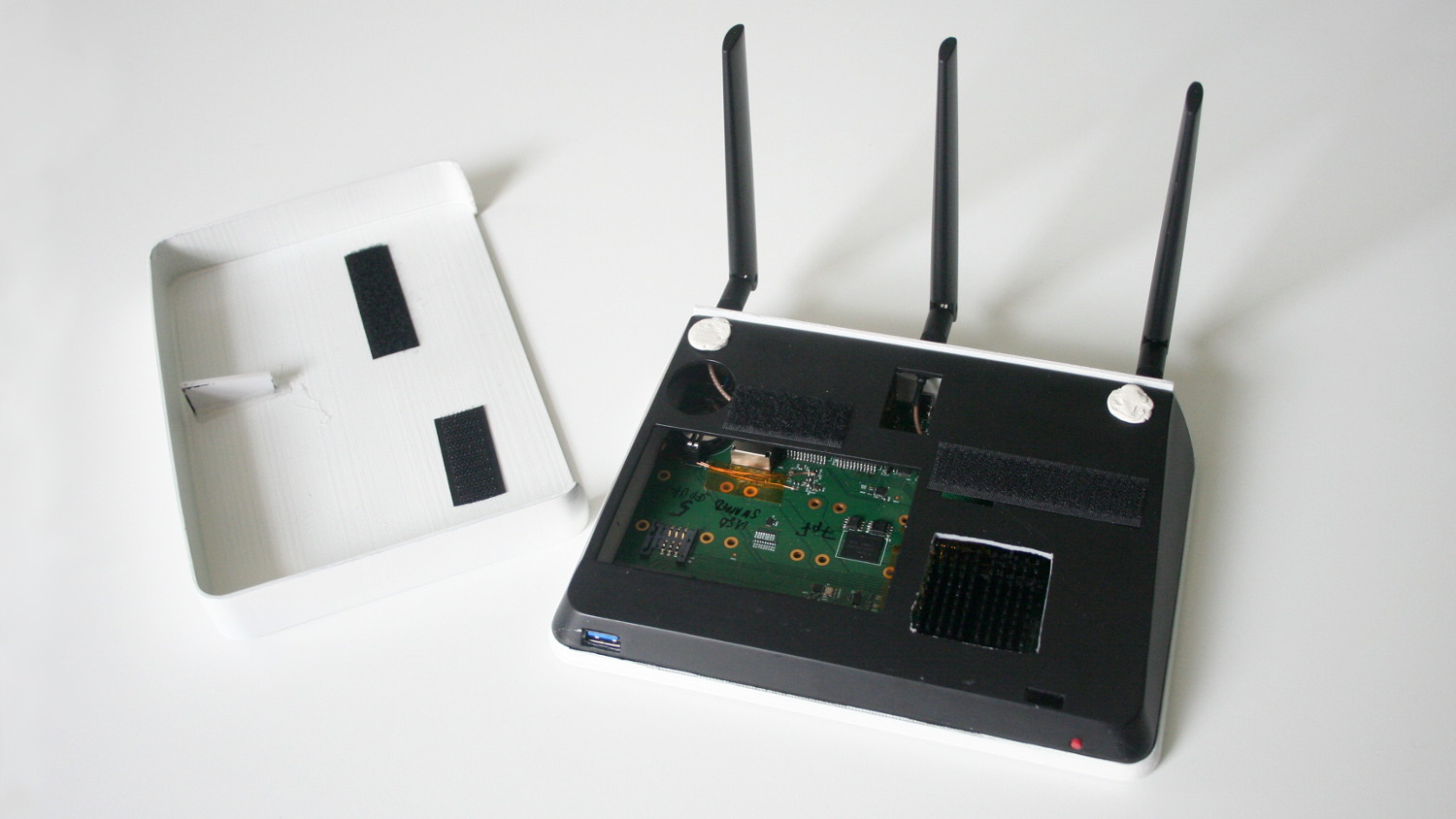

Hey,
I think that whole top cover will be somehow easily removable:) (something like on this prototype pic: http://i.iinfo.cz/images/604/omnia.jpg)
Cheers,
D.
I would like to see similar holes as routerboard for wall mount.
As for the box, we are still working on the design, so nothing is final yet. We would definitely want to have a “hackable” box with support for easy opening, holes for extra wires etc. The challenge is how to make it functional, good looking and not prohibitively expensive to manufacture at the same time.
As for wall mount holes, there will definitely be some.
