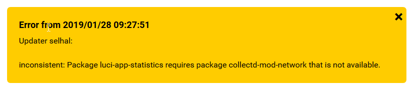

When I added the content “https://repo.turris.cz/hbk/lists/luci-controls.lua” I came across this error.
I already find it … it is “netutils”.

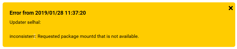

Updater still reports an error.
For NAS plugin missing mountd. It looks like there were not all the required packages on the repo server.
All these reported issues are already fixed in next version of Turris OS 4.0.
For example mountd is no longer available as it was replaced by blockd.
