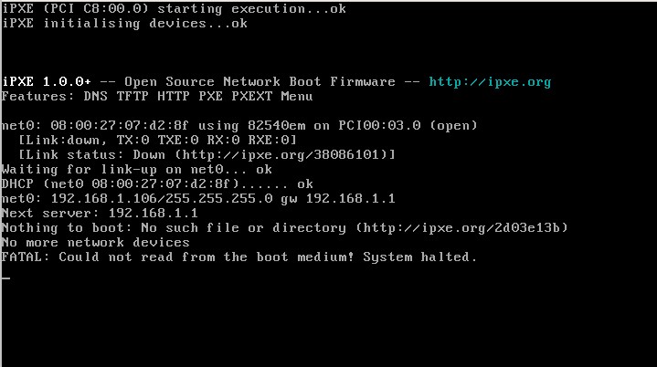

Hi Guys,
I really need a help here, does anyone has a working pxe booting setup?
First I tried to set this up with the LuCi GUI, but it didn’t work, so I added some lines to the dhcp config, that I could find in this Turris documentation:
https://www.turris.cz/doc/en/howto/network_boot
Unfortunately it didnt work either. To be more precise, dhcp itself work, I can get an IP for the client, and also next-server address is also known, but the filename and root-path is not found.
I have tested it with Virtualbox VM network boot with iPXE and also with normal intel PXE on my physical host. Result are the same. I could check in iPXE shell that root-path and filename stringth are empty, so that is why it cannot boot, if i set it there up manually, i can boot to the pxe menu.
I do not know if it is important or not, but I do not have any NFS share for this network boot, I simply try it from Turris filesystem, so /mnt/data/tftp is not a mounted fs but it is a local fs.

Please advice what could be wrong in my config?? Anyone has a working solution?
Thanks in advance
Here is the virtualbox result while booting an empty vm with network booting:
Ok, I solved my own issue. Here is resolution if someone expect some similar issues.
The problem was probably that I have had some hostname and other configuration on the router, so i ended up deleting the /etc/config/dhcp config file and reinstalling dnsmasq and odhcp packages. Thereafter I simply edited the tftp settings in the luci gui, and everything was working as expected.
