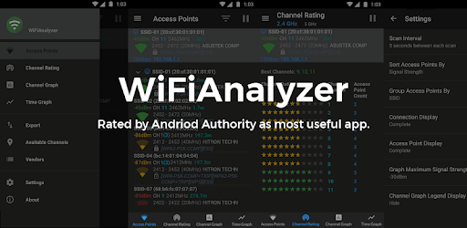

Install this app to look how crowded the channels are and choose the recommended channel.
I switched from farproc’s Wifi Analyzer to VREM’s because it is open source and ad-free :wink:
Thanks for the tip. Gonna change it right a way :).
EDIT: “Your device isn’t compatible with this version” :(.
Samsung Galaxy S4 international edition - i9505 - Android 5.0.1 - Rooted
Yes, it needs API Level 22 aka Android 5.1. I may take on issue #57 (support older Versions) if i got my other projects finished but this will take some time.
Also available on https://f-droid.org/repository/browse/?fdid=com.vrem.wifianalyzer
So, are you saying that Wifianalyzer from vrem is ONLY available to like 40% of all the Android phones??
API level 22 + 23 = 40%
https://developer.android.com/about/dashboards/index.html
This i have never stumbled upon. Is there something in API level 22, so necessary that wifianalyzer should use? That is the only conclusion that i am coming up with.
They originally decided for Android 6 because it gives more info about the wifi networks. 20/40/80/160 informations are not available in 5.1 or lower.
As i though that was the only conclusion that i could come up with.Sadly not going to use it for now.
I am planning to use my Samsung Galaxy S 4 at least till 2020 if it makes it :P. Maybe if a stable Cyanogenmod version is available with maybe Android 6 or even 7 that i then try to put that on it.
I am still glad that i got marshmallow (6) on my phone. It started with 2.3.4. Sometimes i forget that not everyone gets updates.
My future smartphone will probably be a chineese phone running Android. Hopefully then running Cyanogenmod or something like that so i won’t be dependend on companies anymore for updates.
