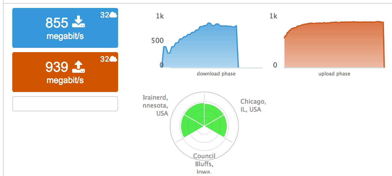

However, when I perform a test seconds later (using dslreports.com’s fiber test) on my laptop, “hardwired” to the router, I get this result:
I realize that wget tests bytes and dslreports tests bits, but why is there such a huge difference between the two when then are converted to bytes (8 bits/byte)?

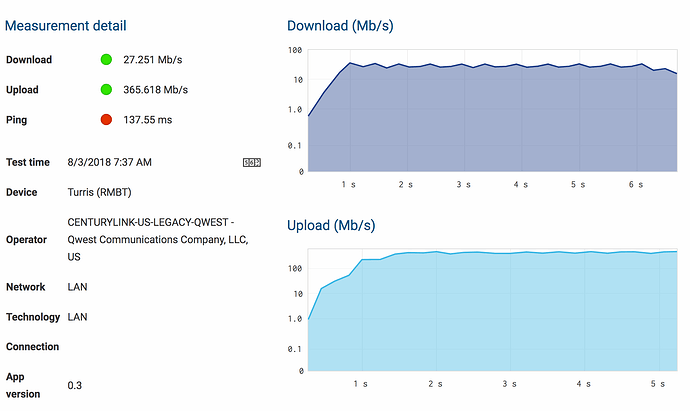

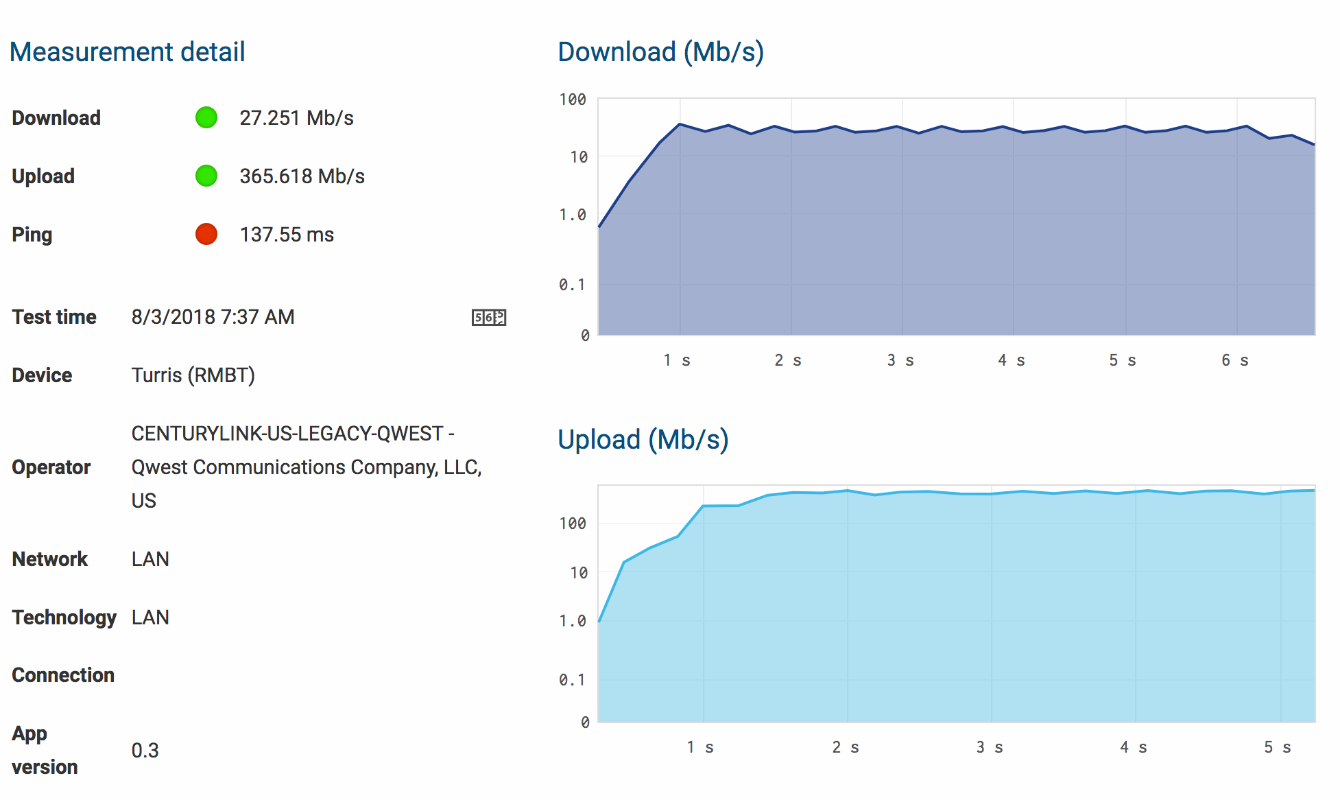

Foris’ netmetr also reporting a lower value, that is consistent with busybox:
