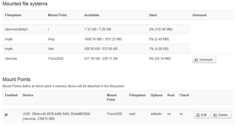

Here are 2 screen shots of the SSD mounted to Omnia.
www.walagata.com/w/nightwalker/Turrisomnia/mountedfilesystems.jpg
www.walagata.com/w/nightwalker/Turrisomnia/networkshares.jpg

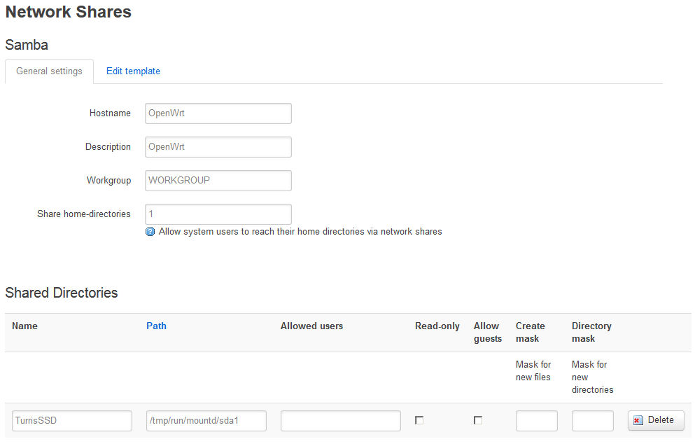

I added a user, gave it a password and filled in the user name at “network shares”. Unchecked “allow guests”. “Read only” is also unchecked. Saved all settings and rebooted Omnia.

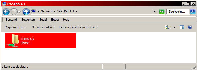

Now I can see the drive on multiple pc’s (win7, XP). After entering the user name and password I can see the content of the drive. Only a Lost+found folder.
But I’m not allowed to write to the drive. I tried to create a folder or to copy a folder with content to it, but I have no permission to do so.
I can’t see anything wrong in my configuration. The “read only” is unchecked.
Can someone tell me what still could be wrong?

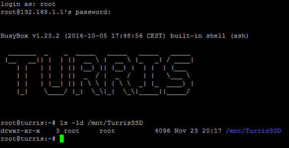

The mount does not belong to the “newuser” (that’s what novyuzivatel means) nor he has rights, as seen above. It belongs to user root and group root, other only has read rights.
Check the file permissions on the disk. If you mounted your disk as /mnt/nas then run command “ls -ld /mnt/nas” from SSH command line to check the permissions.
I checked the permissions. And, indeed, it is set for “root”.
But on the windows machines the root login details don’t work.
How can I change the permission for the user name I added?
Problem solved. After a little search on the internet I found out about the ‘chown’ command to change the read/write permission to an other user.
Directly after I used the next command in SSH,
chown <username> /mnt/TurrisSSD
I had full access to my SSD in the Omnia.
