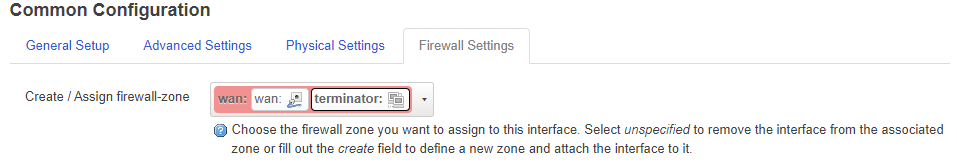

page4 firewall.
Sorry for multiposting but I am forced to.
And my WAN page, I tried to regroup as much as possible.

Can’t tell why they chose two interfaces in one firewall zone - because when bridging them anyways you can also just create one single interface.
Just try and remove the pppoe-interface and enter the VLAN and credentials directly to your WAN.
I have tried to simplify. It did not connect anyway. Is there a basic mistake somewhere?
Try deleting the terminator-pppoe interface and (much more important!) move WAN interface to WAN firewall zone :wink:
