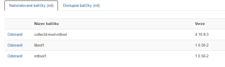

root@turris:/# opkg install collectd
Package collectd (4.10.8-3) installed in root is up to date.
Necessary rrd is too installed but in real missing…
