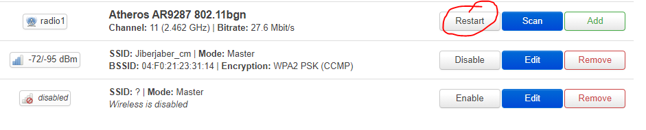

So I would like to put in a little cron job to restart the wireless network… basically replicating clicking this button:
Pointers to how I could do this would be appreciated please?
The command you after searching for is “wifi”.
You can use it in cron as for example
*/5 * * * * wifi reload
or
*/5 * * * * wifi down && wifi
where you can change */5 which means command will be executed each 60/5 minutes (please see man pages for crown) to any preferred value… Please note that WiFi will be interrupted even if working due to wifi reload or wifi down/up crown command :wink:
Thanks guys - useful info will test and see how it goes.
Maybe it is also useful to check if the adapters in question are still connected to the respective AP before a “blind” wifi restart every n minutes/hours, e.g.:
root@blackhole2:~# iwinfo wlan0 assoclist
D2:xx:xx:2x:xE:xx  -47 dBm / -86 dBm (SNR 39)  0 ms ago
	RX: 144.4 MBit/s, MCS 15, 20MHz                 1037 Pkts.
	TX: 144.4 MBit/s, MCS 15, 20MHz                  593 Pkts.
	expected throughput: unknown
needs just a little bit of scripting … :wink:
