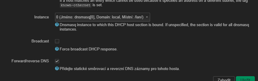

hi, once I set the static domain name in turris luci then I can access it e.g. switch0.lan switch1.lan synology.lan … but reforis does use .local so if I use turris or router then I reach it by router.local.
Local has advantage as the current browser handle it corrently without the need to add schema - often HTTP or https one.

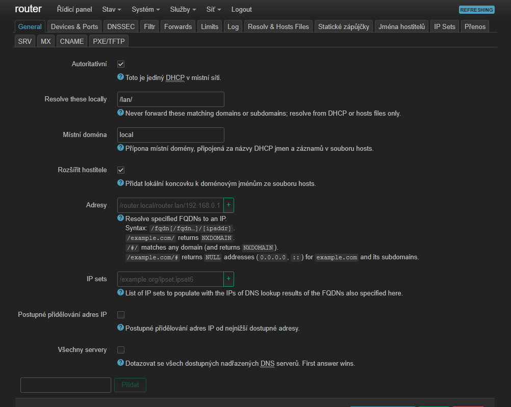

I tried to make it use .local for static leases in luci. but something is broken.
And here even though the setting is completely against this.
its seems to not have been applied. altough I did restart the turris and saved all.

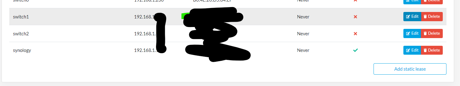

More evidence here:
router was set by reforis and works perfectly:
  • static leases that are made static with hostname are displayed correctly in reforis.

Don’t do that. .local doesn’t belong into DNS. BTW that’s why turris.local can work even if the client’s DNS is set to anywhere (like 8.8.8.8).
The DNS tab in luci is made for dnsmasq, but dnsmasq isn’t used for DNS on Turris (by default).
