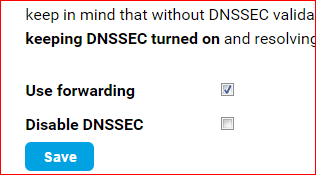

And DNSSEC ???
Wer are each entitled to our own opinion; unfortunately yours would be wrong!! Ignorance is bliss; just keep living in your perfect world of flowers and roses.
I don’t use DNS forwarding and my DNSSEC is enabled. Like I suggested, I know the attacker got in as I could see there was a Current DHCP Lease and therefore know exactly what time the Attacker managed to get them self on the network; I even know the device they used through the MAC address and the Default name, although of course these can be faked.
