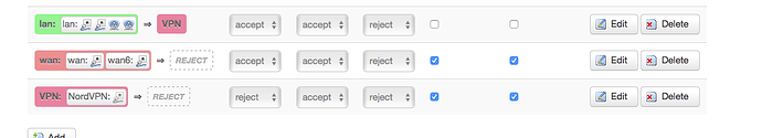

I had the below interface setup, i want it so that if there is no VPN nothing goes through, but to also have bypass for netflix BBC iPlayer etc. I dont really know if this is correct.

your zones need to look something like this
and you paste the following script into the bottom of your startup screen (system >> startup) before the exit 0. restart your router and we are done.
