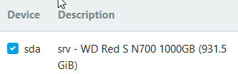

To add storage for write-friendly software, I tried to add an NVME drive (WD Red SN700 1TB) via a no-name SSD enclosure (actually presenting itself as Realtek RTL9210B-CG) and expected to get hit by this bug, but found out, the enclosure is presenting the drive as hdd:
grafik
root@turris:~# lsblk
NAME         MAJ:MIN RM   SIZE RO TYPE MOUNTPOINT
sda            8:0    0 931.5G  0 disk
mtdblock0     31:0    0     1M  0 disk
mtdblock1     31:1    0     7M  0 disk
mmcblk0      179:0    0   7.3G  0 disk
└─mmcblk0p1  179:1    0   7.3G  0 part /
mmcblk0boot0 179:8    0     4M  1 disk
mmcblk0boot1 179:16   0     4M  1 disk
root@turris:~# cat /sys/block/sda/queue/rotational
1
root@turris:~# lsblk --discard
NAME         DISC-ALN DISC-GRAN DISC-MAX DISC-ZERO
sda                 0        0B       0B         0
root@turris:~# mount | grep sda
/dev/sda on /srv type btrfs (rw,noatime,space_cache=v2,subvolid=256,subvol=/@)
If I am correctly informed, it is crucial to get it detected as SSD, otherwise the device would wear out much faster, correct?
Is it dependend on the enclosure (/chipset) whether the SSD will be detected correctly or is this something that happens to all external devices (the same happened to me for a mSATA-drive, that was correctly detected as SSD when put into TO mSATA-slot or external mSATA-USB3-enclosure)?
(I did not choose this very drive for its NVME-speeds, but for the very low power consumption - the router is maintained by solar energy with only a small battery - and maximum drive writes compared to disk space so durability).

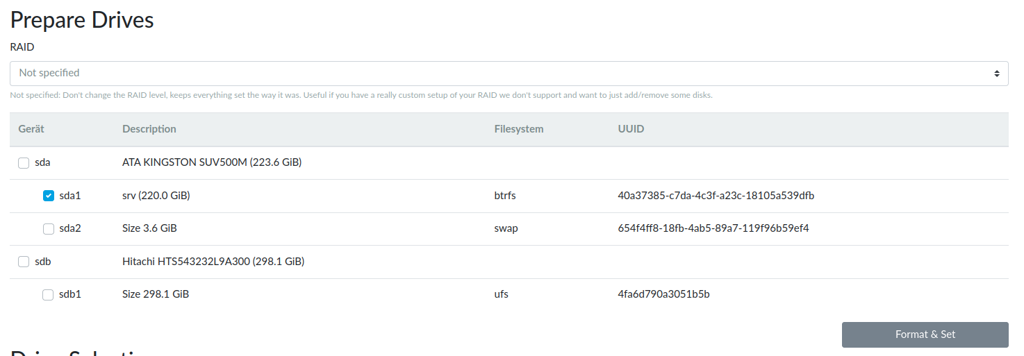

Linux does not care about whether a drive is inside the computer box or not, it’s the connector that matters. Since you asked, I got curious and hooked up my own external HDD, now ReForis looks like this:

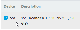

so still the same problem, even though with this enclosure chipset at least the storage device itself is recognized:
grafik
  • noname portable m.2 SSD-enclosure with ID SHL-R320:
root@turris:~# lsusb
Bus 003 Device 003: ID 0bda:9210 Realtek RTL9210
sda                 0        0B       0B         0
grafik
this time even stating it holds an NVME-device…
