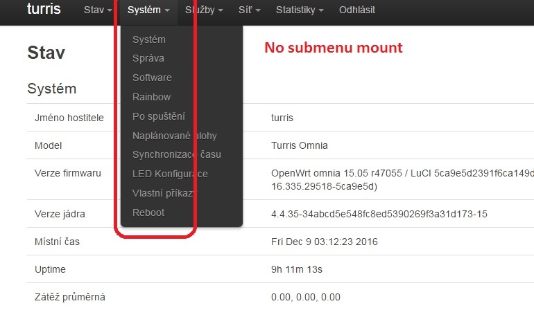

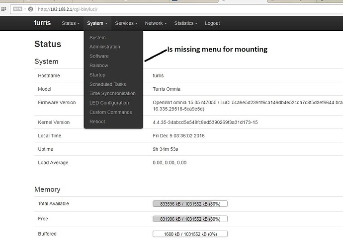

I am stupid or blind … last week, I create the mount point (flash drive) for data Majorodomo, now todday I not see an option menu “System-connection point” in LuCI. I think (not shure) if flash is mounted

This command will affect to the off menu LuCI ?

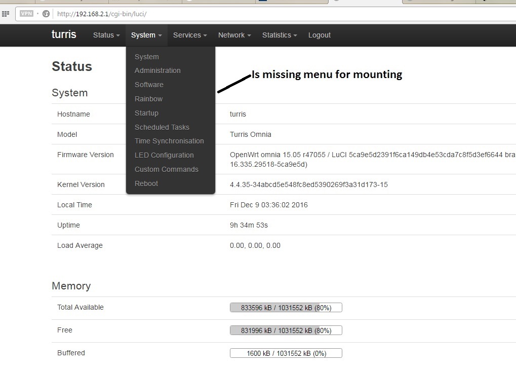

The required submenu “Mount point” in the menu “System” is not available.

For me the many is there but I’m using English localisation.

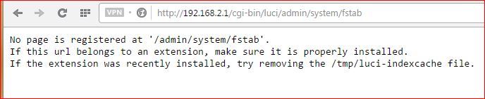

Can you reach the mount page with a direct link?
Replace my ip with yours.
http://192.168.21.1/cgi-bin/luci/admin/system/fstab

Problem is solved.

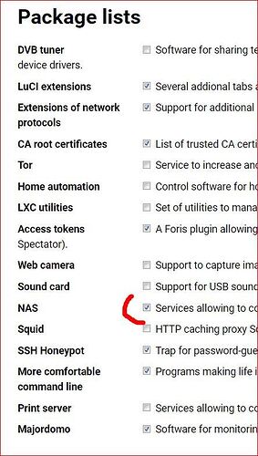

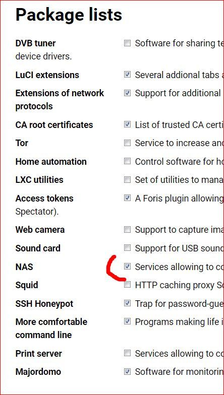

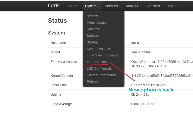

In Foris “Updater” again check choise “NAS” (before updating it was checked)
In the LuCI appears again option “Mount Points” … its all.
