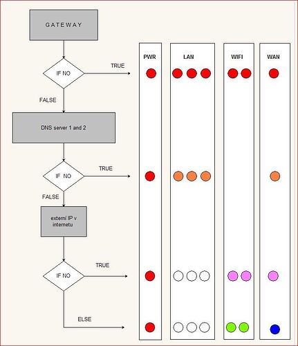

Logical flowchart

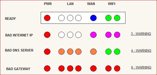

Similarly, the schema of LED color warning
