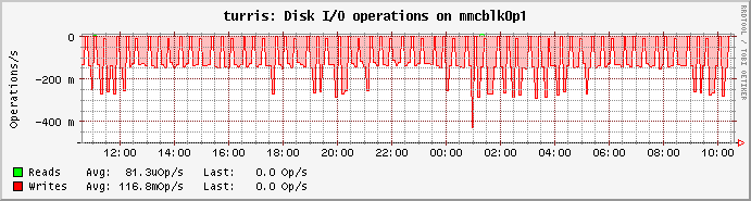

Kresd writing to disk every 10 minutes
So apparently kresd is writing to the eMMC every 10 minutes, which is far from ideal:
[570377.392886] kresd(20355): dirtied inode 3359031 (data.mdb) on tmpfs
[570377.395009] kresd(20355): dirtied inode 1 (?) on mmcblk0p1
[570377.396884] kresd(20355): dirtied inode 409443 (root.keys.lock) on mmcblk0p1
Due to a bug in init file, kresd is currently restarted every 10 minutes (I’m not certain if every Omnia gets caught into this loop).

after this fix, there is still something writing to disk, every 60minutes, far less often than before, but still not “ok” for a eMMC
