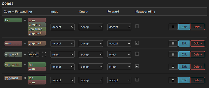

Hm I have edited the rule with Accept - Accept - Accept.
Now it seems packets are just dropped. No more Port unreachable, just 100% packet loss
Tried with these settings now:
When you set accept-accept-accept on wan zone you basically disable the firewall which is a security issue
