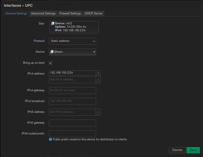

If you want to reach the modem, create a new virtual interface assigned to eth2 (similar as is with WAN6 interface) and assign it a static address in the 192.168.100.0/24 range. Add it to the WAN firewall zone and then you will be able to reach the modem with its address 192.168.100.1.
Tried it, but without the DSlite ipv6 does not work to the outside.
apperantly this ISP ( ziggo /upc klopt Jan, UB13 kabelmodem ) ) needs the Ds lite.
So back to the config you suggested without the DS lite '0" line, ipv6 works. Ip4 gateway only works after i manually de mark and mark the default gateway option in the ip4 config?
