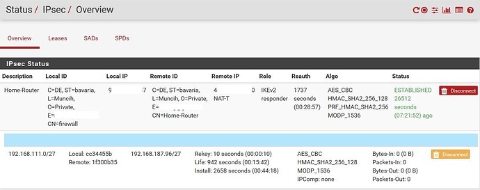

Pfsense Phase1 Tunnel configuration:
Pfsense Phase2 Tunnel configuration:
Pfsense advanced configuration:

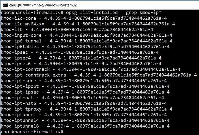

Turris Packages:

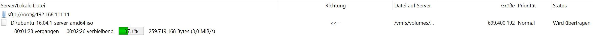

What maximum throughput do you get on to?
I didn’t test the speed til now.
I’ll make a test and post the output here
I have 1gbit upload on root Server side
And 120 Mbit download at home.
Sorry for the late reply.
Here are 2 screenshots. Don’t know why the single download won’t go ober 3 MiB/s.
But when make more downloads at same time i reach around 10 MiB/s .
