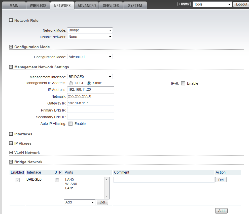

Btw. this is settings of the Linksys
For network layout please refer to my first picture in this thread.

Your Linksys configuration has a static IP address. Did you try that instead of Unmanaged?
yes, Linksys works fine with both static IP and DHCP, does not allow Unmanaged. On Omnia I tried all three settings but no luck
