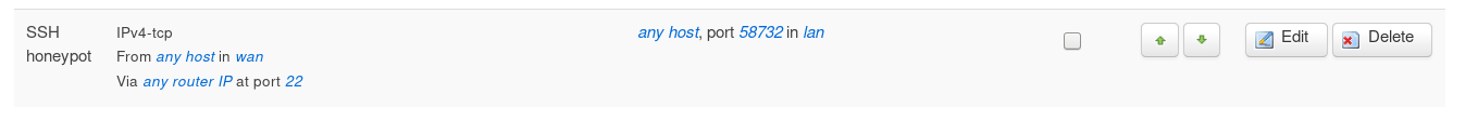

I’ve found there are some relicts in firewall settings:
I’ve removed them because I don’t need to access my router from outside.

Port forwarding 22 is not needed for use from the inside. For VPN I do not know, but I would say that VPN should (MUST) * * * strictly * USE!!! * * another port * *, therefore VPN is used. Then there is no external access to 22 SSH.
The new SSH honeypot does not need to redirect anything, sets its private proxy.
We should probably honeypotu the Hass = Another function, different settings.

But honestly. The port forwarding you had to set yourself? According to the original manual. :wink:
