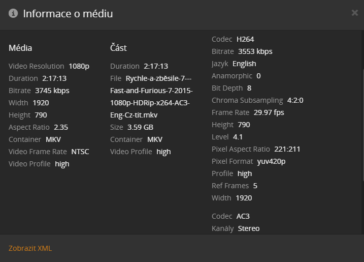

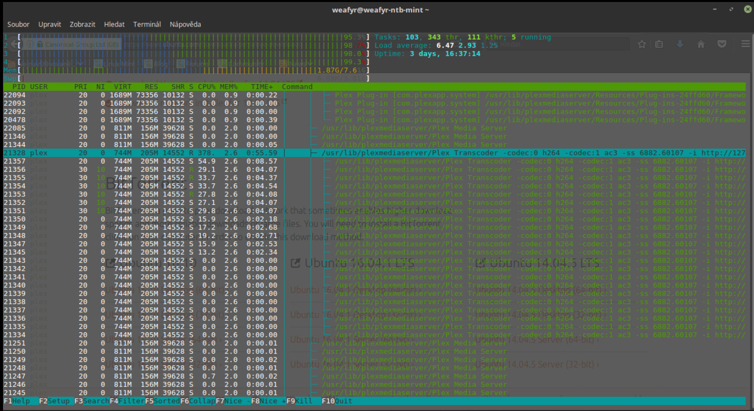

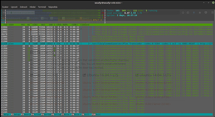

It is not so hard to run Plex server on turris, you can use one of tutorials for rpi on google. I get it run in the LXC ubuntu container. But the turris is not enough powerfull to do transcoding, which is for me important as I want movies with subtitles. So I decide I will use one of my old laptop with i5 as standby server with Plex. Just for comparison, coding of 1080p movie take about 80% of Core i5 2410M, on Linux Mint 64Bit.

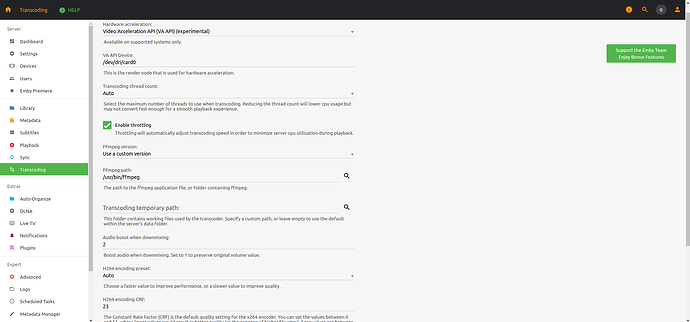

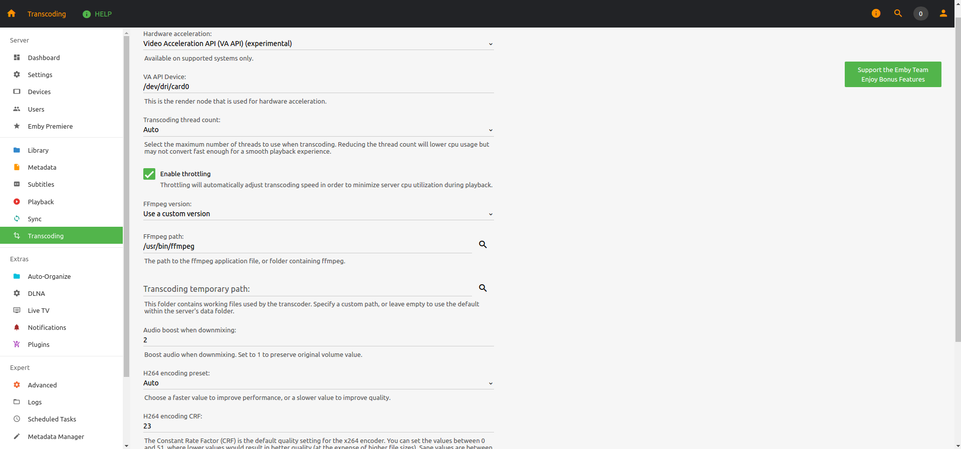

The other day i was on the forum of Emby Media Server and they were discussing VA-API for hardware acceleration to be used for transcoding. They got it working, so even with a not so powerful cpu, you could get Emby Media Server doing the work instead of Plex.
Although the last time i checked, Plex also uses FFMPEG for transcoding, they (plex) has not yet implemented the functionality to use a hardware acceleration possibility. FFMPEG has implemented this from version 3.x or 3.1…i am not so sure which it was.
