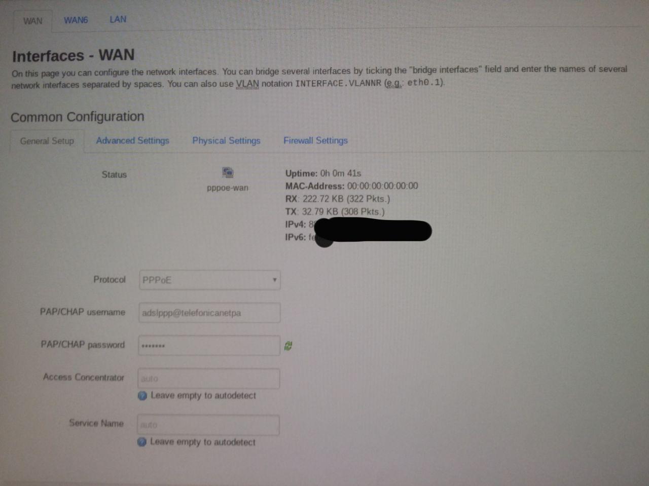

I tried to configure it from fortis and from luci like this
but I still can’t get it to get to the internet from a web browser

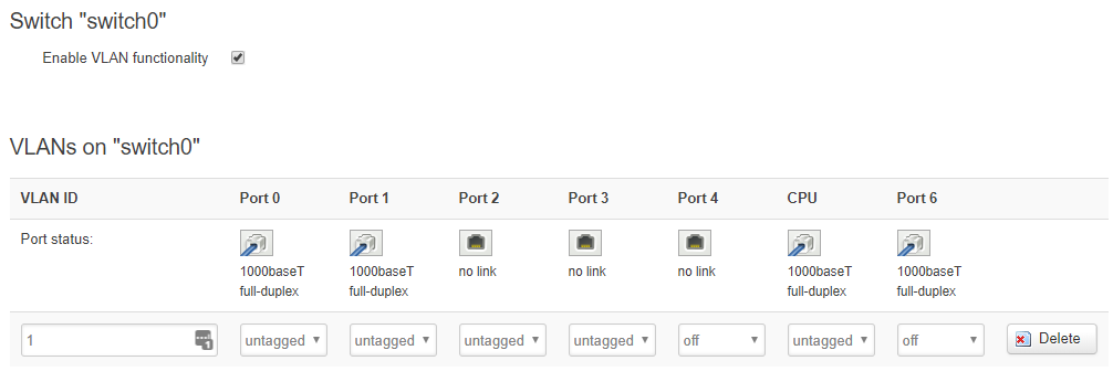

I did create a vlan like this, as advised in the first link
Should I modify anything here?

This is all I have under the switch configuration.
Try to drop the second line.
Thanks a lot for the answer. Unfortunately doing this too doesn’t seem to solve it and get a connection. I must be missing something else. I configured just like in all the previous screenshots, including yours-

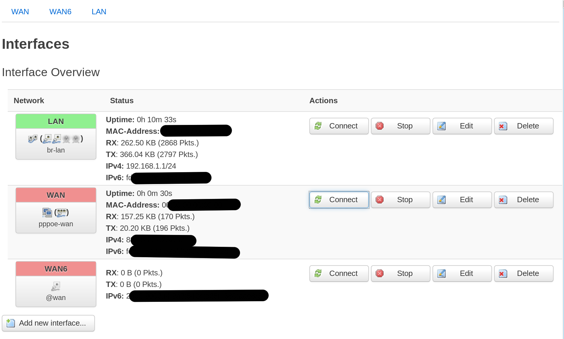

The screenshots in my original post are “work in progress” and probably incorrect. This is how it’s configured now:

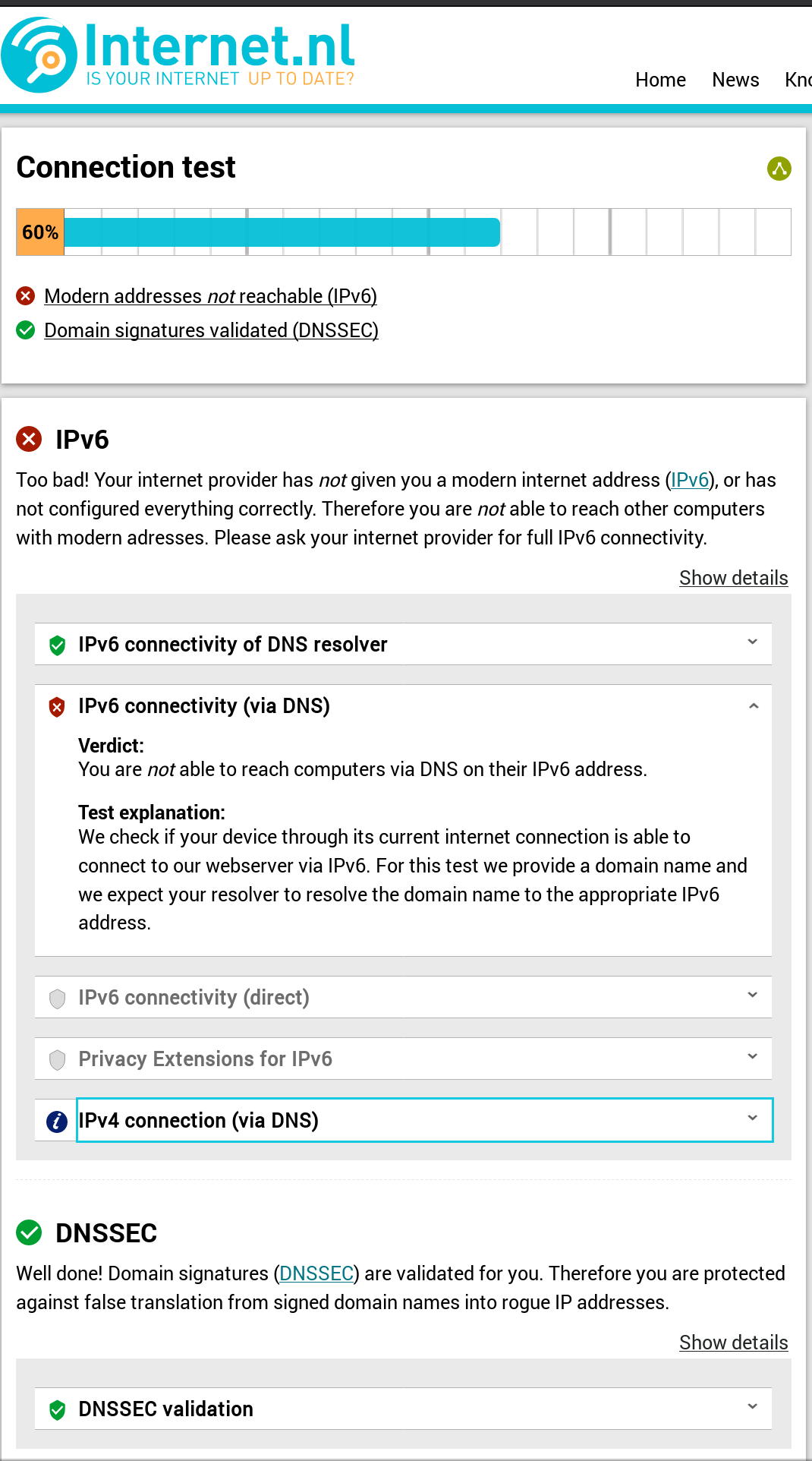

I think I found that the main culprit of my connections problems with this ISP is the dns stuff. I tried deactivating dnssec and now it connects, although I still get connection error with some apps like youtube or newpipe in androids

BTW what do you get here in the connection test?
For me it passes with 100%. Can you successfully ping an ip address, for instance 8.8.8.8? What if you connect your computer directly and bypass the router? Sorry, but I’m a notice when it comes to network configuration.

Now I get this in that test, do you have any idea about where or how to configure IPv6?
I’ve also read people complain about not being able to use dnssec with movistar. Are you on that isp with fiber too?
