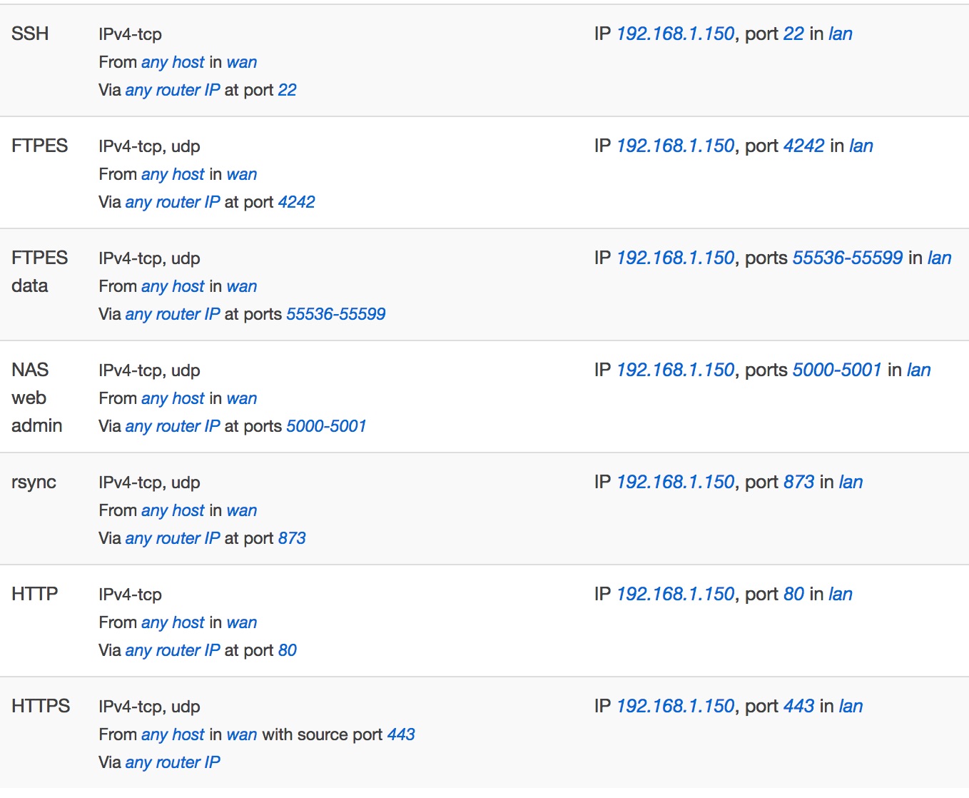

Here’s the configuration:

It might be a stupid question but as it is not obvious from the screenshot I ask - do you have the rule for 443 enabled? Also I assume that it worked for you with old router and therefore your ISP is not blocking it, right?
Yes, it’s marked as enabled in the LUCI interface. I expect I can check it through the command line somehow as well?
Yes, it worked with my previous router.

I see one difference against my entries for the middle ones:
DNAT tcp -- 192.168.1.0/24 dhcp-5-186-71-60.ip.fibianet.dk /* HTTPS (reflection) */ to:192.168.1.150:443
DNAT udp -- 192.168.1.0/24 dhcp-5-186-71-60.ip.fibianet.dk /* HTTPS (reflection) */ to:192.168.1.150:443
I’m missing tcp (or udp) dpt:https when comparing with my setup.
could you check the entry in /etc/config/firewall file? My looks like:
config redirect
        option target 'DNAT'
        option src 'wan'
        option dest 'dmz'
        option proto 'tcp'
        option src_dport '443'
        option dest_ip '192.168.1.130'
        option dest_port '443'
        option name 'HTTPS to DMZ'
config redirect
option src 'wan'
option dest 'lan'
option proto 'tcp udp'
option dest_ip '192.168.1.150'
option name 'HTTPS'
option src_port '443'
I’m running out of ideas - last one would be to delete the rule, restart the firewall, create the rule again and restart the firewall once again. It looks to be configured properly to me.
The port 443 is indeed not opened to WAN. I tried to scan your IP and this is the result:
Starting Nmap 7.12 ( https://nmap.org ) at 2017-01-26 11:52 CET
Nmap scan report for dhcp-5-186-71-60.ip.fibianet.dk (5.186.71.60)
Host is up (0.042s latency).
Not shown: 992 closed ports
PORT     STATE    SERVICE
22/tcp   open     ssh
25/tcp   filtered smtp
80/tcp   open     http
445/tcp  filtered microsoft-ds
873/tcp  open     rsync
4242/tcp open     vrml-multi-use
5000/tcp open     upnp
5001/tcp open     commplex-link
Interesting are the ports 25 & 445 as they are not listed on your screenshot above. Did you allow them somewhere else?
