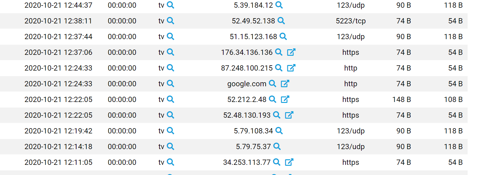

Good, since i do think there is something ‘less optimal’ working atm. ( TurrisOS 5.1.2 omnia )
Already mentioned it in the update topic, but even if i make a rule to block in and outgoing WAN traffic from a local IP, it does not do anything…
Pakon even shows the I/O traffic

hmmm, edit…pakon does not agree? interesting, since if i test the tv internet connection with the update function, it says 'bad connection" and network check on TV says yes to lan, but not outside.
hmm, ok, now pakon stopped working. Re installed it, but the last line in the syslog is this one
