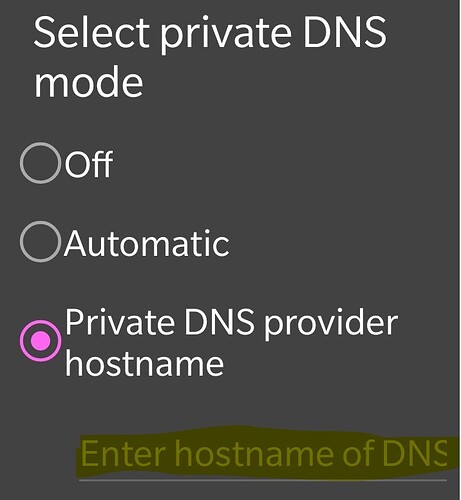

If I enter the hostname from the router in Android in the Option “Private DNS provider hostname”,
below the “Enter hstname of DNS” entry I get this feedback.
Ah, I see. That’s a name to verify TLS certs against, like in https://hostname . This “Let’s Encrypt route” is more secure but more difficult to set up.
What happens when set to automatic instead?
