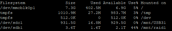

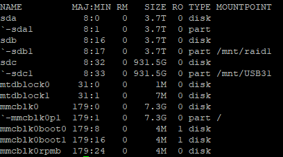

However, when I use df -h and lsblk it looks to me as if only sdb is mounted.
df%20-h
lsblk

´cfdisk´ also does not show a RAID.
It is not part of a RAID(1) array then and just the mount point is /mnt/raid1
that’s what I assumed. But why do both have the same available space then if I don’t have sda mounted to anything :thinking:

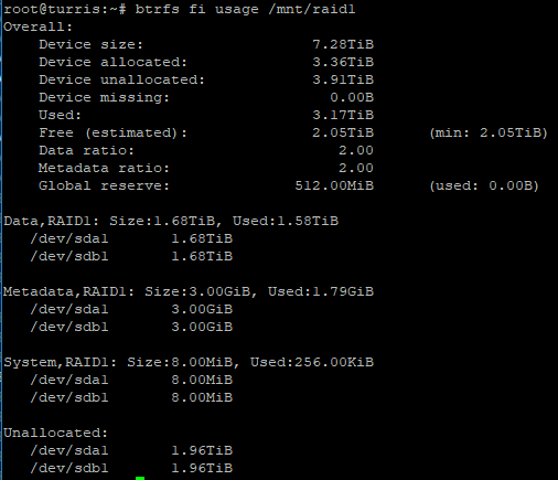

Edit: OK, the mount is /mnt/raid1 and using btrfs fi usage /mnt/raid1 gives the following:
raid1
I did the raid1 with btrfs. I feel stupid now. I think I also remember now. The creation of the RAID1 using mdadm was putting a very high load and for some reason caused the creation to fail. I then tried with btrfs and it worked…
