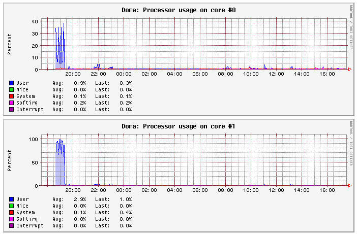

second to that, my CPU is on 0.1% - 0.2% all the time :slight_smile: Any guide will be appretiated

thanks for hints. On default configuration (min 800, max 1600, governor performance, driver cpufreq-dt) Ive got 0 transitions, running on 1600 all the time :frowning:

Mea culpa! I would expect that behauviour at all.
The system actually doesnt allow me write to these files… In repo there are no cpufrequtils or such…
cat /sys/devices/system/cpu/cpufreq/scaling_cur_freq
givs me 1600000
after
echo “ondemand” >> /sys/devices/system/cpu/cpufreq/scaling_governor
givs me 800000
but temperature is still the same around 59C
and power consumption seems to be same too
thanks, it looks like working now :slight_smile: Although I didnt observe much temp affect either, so at least on “paper” it works. Dunno if there isnt some other issue under.
