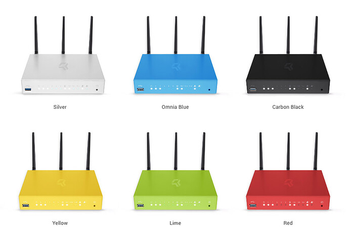

Color of your Turris Omnia
I voted for lime :green_heart: :relaxed:
I found in my email these six colors to choose from. :slight_smile:
hey guys, how about making a batch of the Silver white? How many more of us wants to order a white one?
