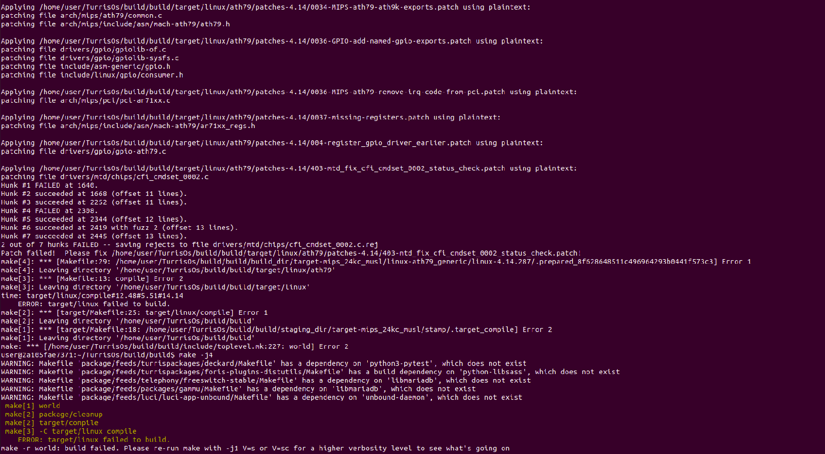

I am trying to compile and build the turris omnia firmware in a docker container according to starter guide @Turris / Turris OS / Turris Build · GitLab. Simply, the steps are,
  1. git clone
  2. in /turris/build/ run ./compile_pkgs
    3.git checkout hbk
    4.make menuconfig (nothing changed, default)
    5.make -j4
The problem is:
I get the errors on the ath79 patching , during /target/linux compile steps.
Below you can find the screenshot of the error which was run in debug mode.
PS: I used Ubuntu 20.04 and the last version v5.0.0.03 with hbk development branch.
Thanks,
Didn’t it fail with output: No board selected!?
You should carefully take a look at README in Turris Build repository, which you referenced. There are all steps described, which you need to do.
This needs to be done before running compile_pkgs script.
It fails, because you are not building packages for Turris routers, but for OpenWrt default, which is Atheros ATH79.
