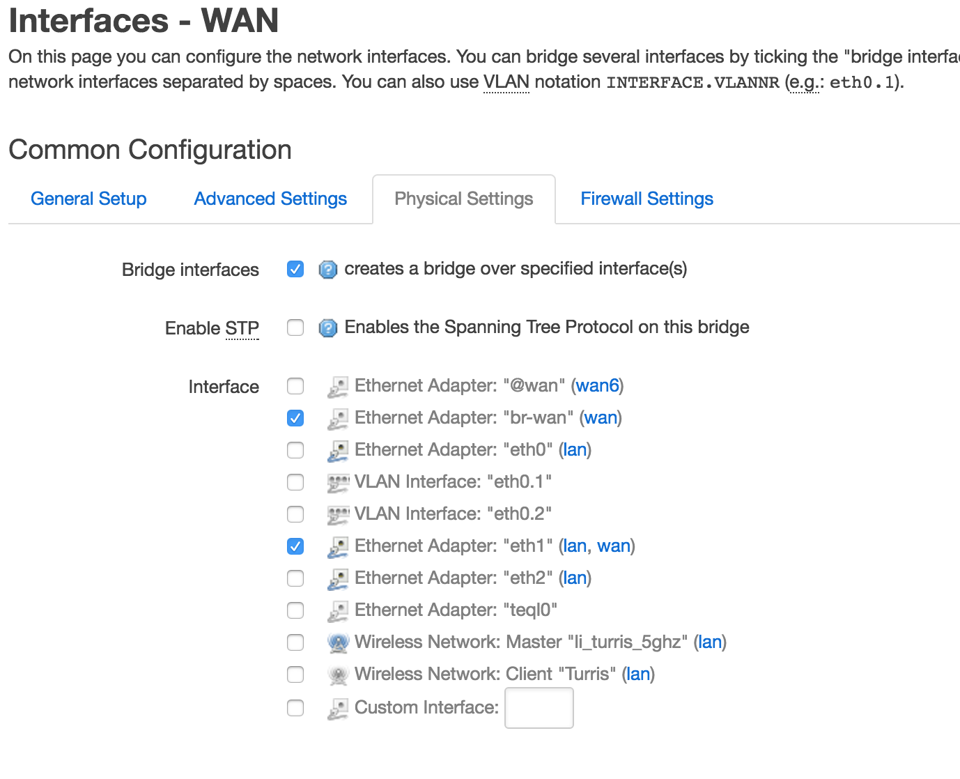

I’m trying to do an auto update but the updater is not finding an internet connection because it currently expects it to be coming via the WAN port. I tried bridging the WAN interface with LAN (eth1). WAN is currently set to DHCP.
Here are some screenshots:
Physical Settings for WAN:
I would appreciate if someone could point me in the right direction here.

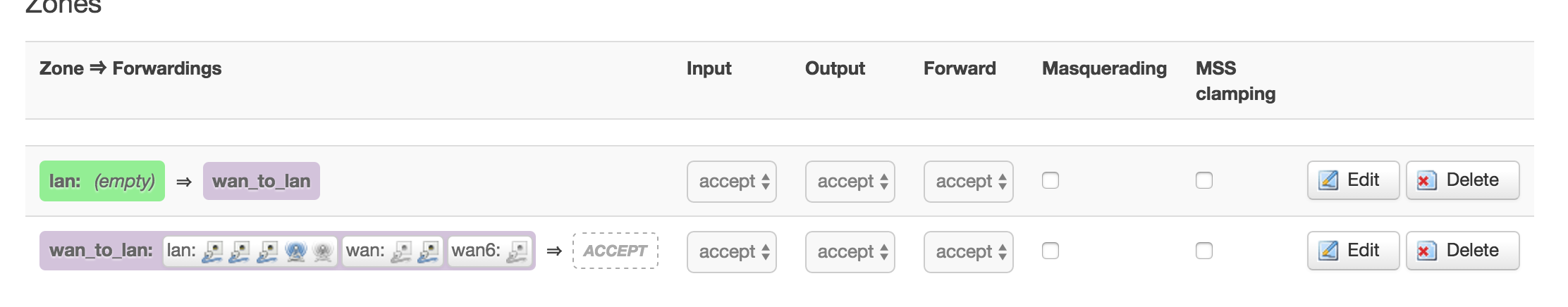

EDIT2: What about (LuCi) Network --> Firewall
Everything FROM WAN to LAN is being rejected. (Firewall). So logically speaking, if you disable this or just accept everything…then i guess things should workout the way they should right? You have not forwarded anything from your Primary router to your Omnia, so would that be oke?
If anybody knows what i do not please do correct me.
I’ll give the firewall setting a try too when I get home. Thanks.
Hmm…the two cable solution seems to cause me to lose access to the Turris Omnia once I plug into the WAN port.
I tried the Firewall solution… is this right? It doesn’t seem to work either.

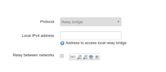

@geo_lee, i MIGHT have found another solution with only 1 cable.
Relay bridge. I am not sure of it, but in theory it might kind of work.
https://wiki.openwrt.org/doc/recipes/relayclient
When you on your LuCi–>Network–>Interfaces—>WAN (edit)–>Click on “Protocol” in the “general setup”. All the way down you see “Relay bridge”. Can you experiment with this a bit?
BTW: Don have LAN in your WAN zone(Purple). You have LAN in your WAN zone.
In your WAN zone should ONLY be having “wanX” in there.
