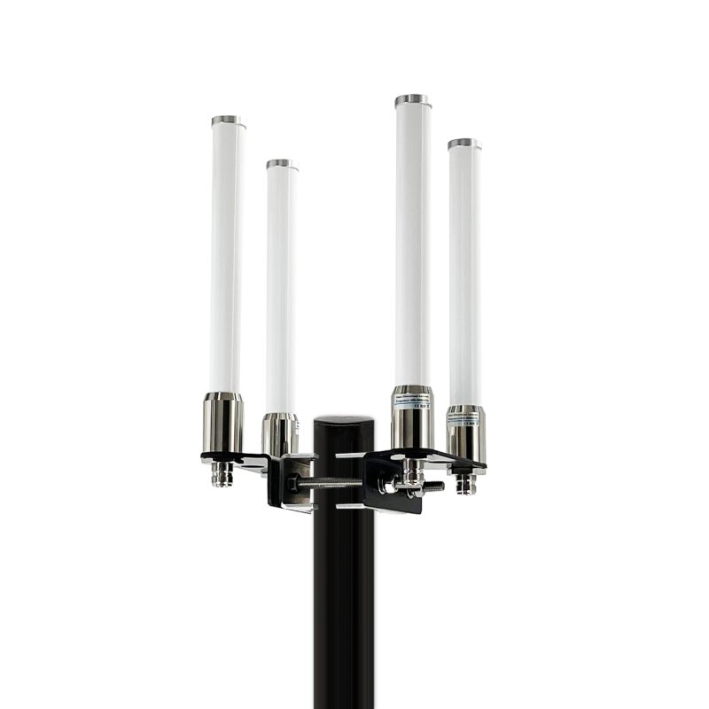

I am quite happy with these antennas:
They are available with 2×2 and 4×4.
You will need additional RP-SMA to N cables to attach them to your router.
Using this one; seems to do the trick (5G’s only backup for me, though). I got the 3m cable version so I could have some reasonable flexibility with placement. Looks suprisingly good on a VNA, given the price…
