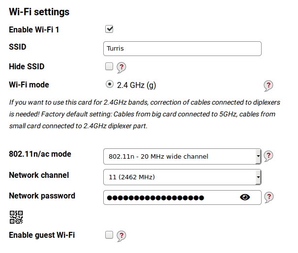

There is no 5GHz WiFi setting in Forris. I can only make 2.4GHz settings. The Turris Omnia is up to date and reset. I also checked the antenna connections as explained in the wiki. Looks correct.
hi there. Must admit that the 5G is alsogone here. After that rebot it did work for a few dats, but now it is gone. It still is available in Forris, but it is gone as working AP.
happened after the latest update. 2.4 is still working.
