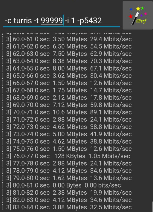

My issue is that it’s loosing throughput the longer my devices are connected to it. My S6 starts out at 260 Mbit on iperf, but goes down to below 100 Mbit after some hours. Disconnecting and reconnecting the phone restores the 260 Mbit throughput. Any idea what I could look into? Thanks a lot.

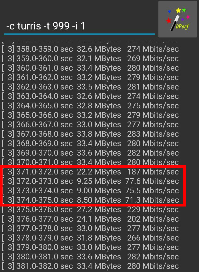

Thanks a lot. At least it makes throughput much more steady for me and yields a bit (~20Mbit) higher throughput in iperf. Those wild fluctuations are gone. It still has some breakdowns every couple minutes, but so far it seems to get back up.
I’ll stress test it some days and report back.
Actually those breakdowns all look very similar. First down to ~180Mbit, then down to ~70Mbit and it lasts always around 4 seconds. Nothing in the logs, though.
