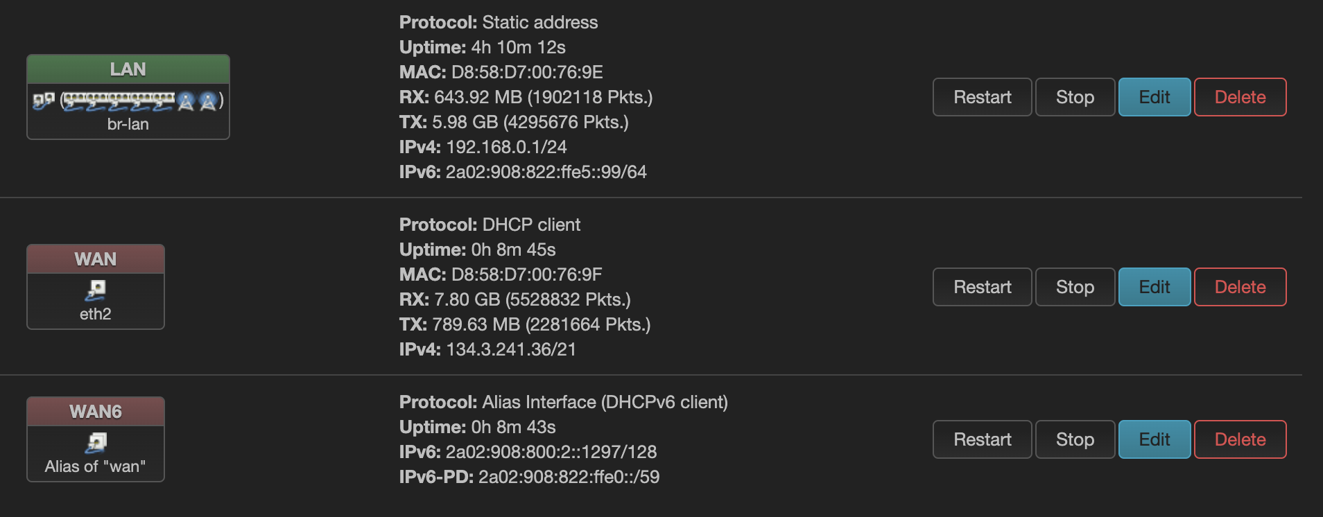

Here you can also see that PD is working properly.

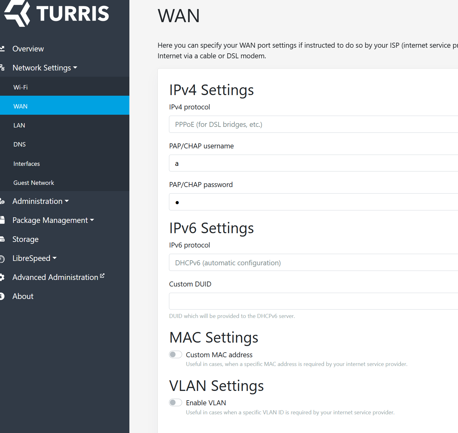

do you use PPPoE? Such as
No, I am not using PPPoE. Both IPv4 and IPv6 are set to DHCP.
